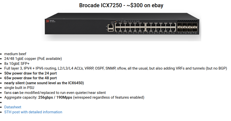

Stick to Brocade ICX like the 6450 or the 7250. DAC's from 10gTek work fine, FS.com has any other things you need. Brocade tends to be far less picky.
I run a 6450 for 2 years now and am working to get my 6610 online but additional fans added to keep the temps down so built in fans don't rev up.
Some models can be fan modded as well, but some can't or take a lot of work (you do not just wan tot try and swap lower RPM fans as the models like the 6610 run HOT)

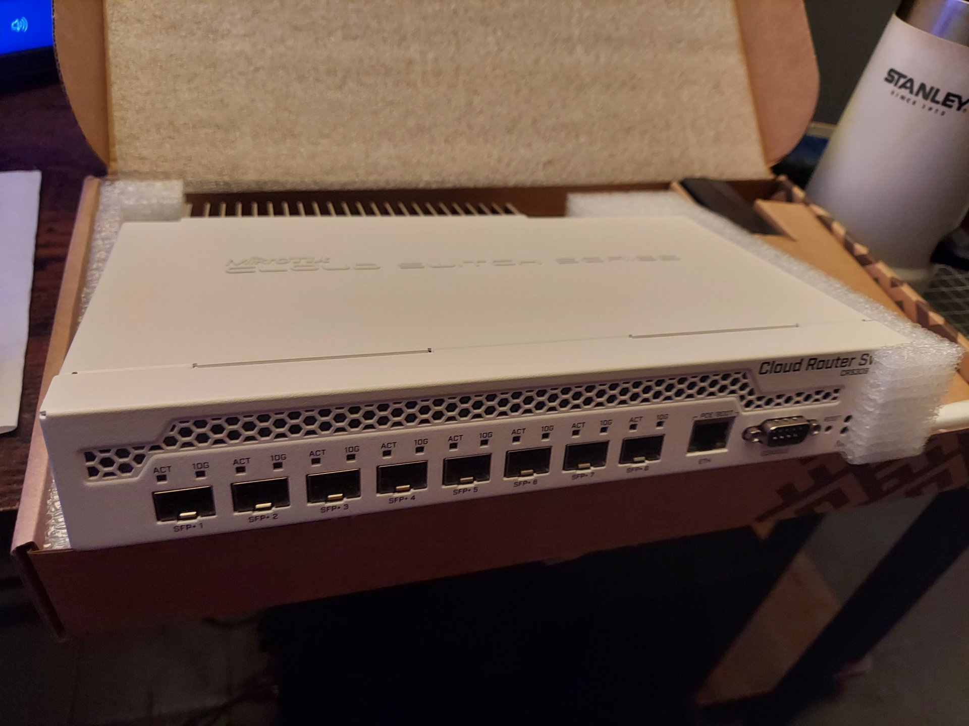

MikroTik CRS309-1G-8S+in is what I went with. Didn't have room for rack gear or needed the extra noise. SMB multichannel works great fwiw. Good way to utilize unused ports.
