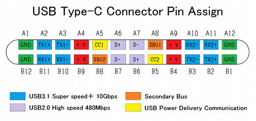

It would be they are only wiring over the D+/D- pins which only do usb2. They would have to wire the RX/TX pins for usb3
It is a big confusing thing for a lot of people actually. USB type C is just the name of the connector, it has no bearing on its capabilities other than it is reversable.
