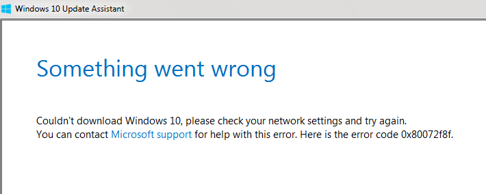

Somehow the Windows 10 Upgrade thing started but then I got this.

View attachment 693470 Somehow the Windows 10 Upgrade thing started but then I got this.
i didnt say to use the update assistant...

Okay, you've accepted the caveats and moved on to this paragraph. Did you look up that media creation tool error? Did you follow the simple solution instructions? https://answers.microsoft.com/en-us...-0x20000/4f8bbe1c-b5af-4cc9-958e-c6c8f3f0b524 It's literally because your system is so old it can't use the protocols required to talk to the servers. You can also run the MCT and create USB install media on another computer. Just pay attention to the prompts and it won't try any upgrades on the host system.

I gave you a link to the instructions to fix your error and get the official Windows 10 download in Post #20 (as well as an alternative method). It even installs to your USB stick.
Get Rufus 32bit here, if you still want to go that route, but you will still need to either apply the Win 7 TLS patch to your laptop or use another computer in order to run the Media Creation Tool and get the ISO.
what is the patch for? where would I get the patch?
The reason you can't use the official creation tool (the error you posted), is because by default, Windows 7 is only able to use TLS 1.0 to securely access the web. TLS 1.0 isn't supported by Microsoft's servers anymore, and the world has moved on to the current TLS 1.2 (your web browser is actually using the even newer post-Win 7 1.3). Win 7 SP1 does have support for this standard, but it isn't activated. The patch you download and install changes a couple registry entries to activate the feature and allows your system to contact Microsoft and use the tool.
In the link I gave you, the first post has a link to download the patch. Alternatively, let me do it for you.
