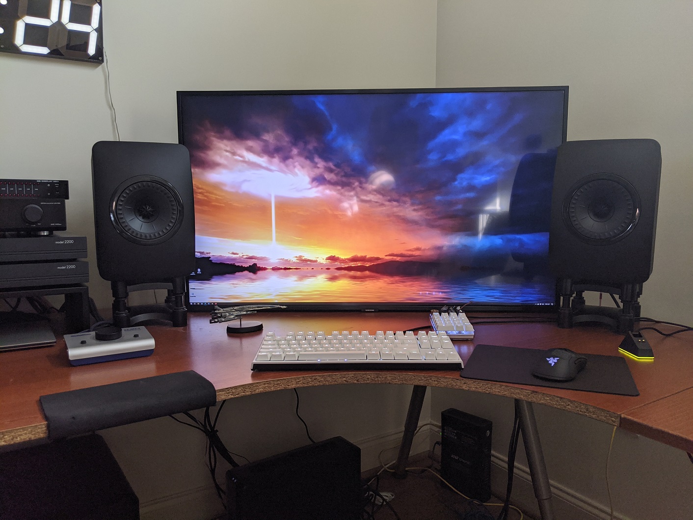

I'm about 2 feet away. Here's my setup...
