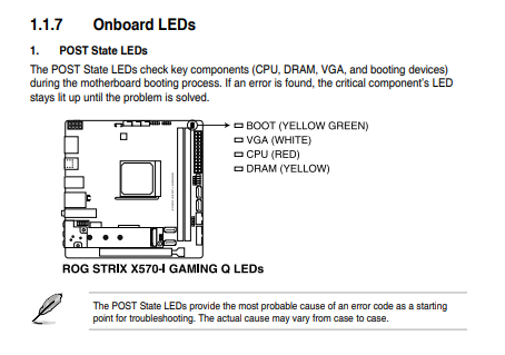

So, put everything back in the case, powered it on.... Nope, back to the same thing. Hit the power button, fans turn on, RGB on MB+GPU, but no display out. you hit the power button again, it shuts down immediately.
VGA LED is on the MB, white LED per the manual is the VGA error.
Ha ha. Big brain moment right there. Regardless, I still don't know why I was having trouble the first time around when everything was in the case.
see if it does that when you just short the pins rather than use the button.
Same thing when shorting the power button pins. LEDs light up and cycle colors for a few seconds and then solid white LED.
