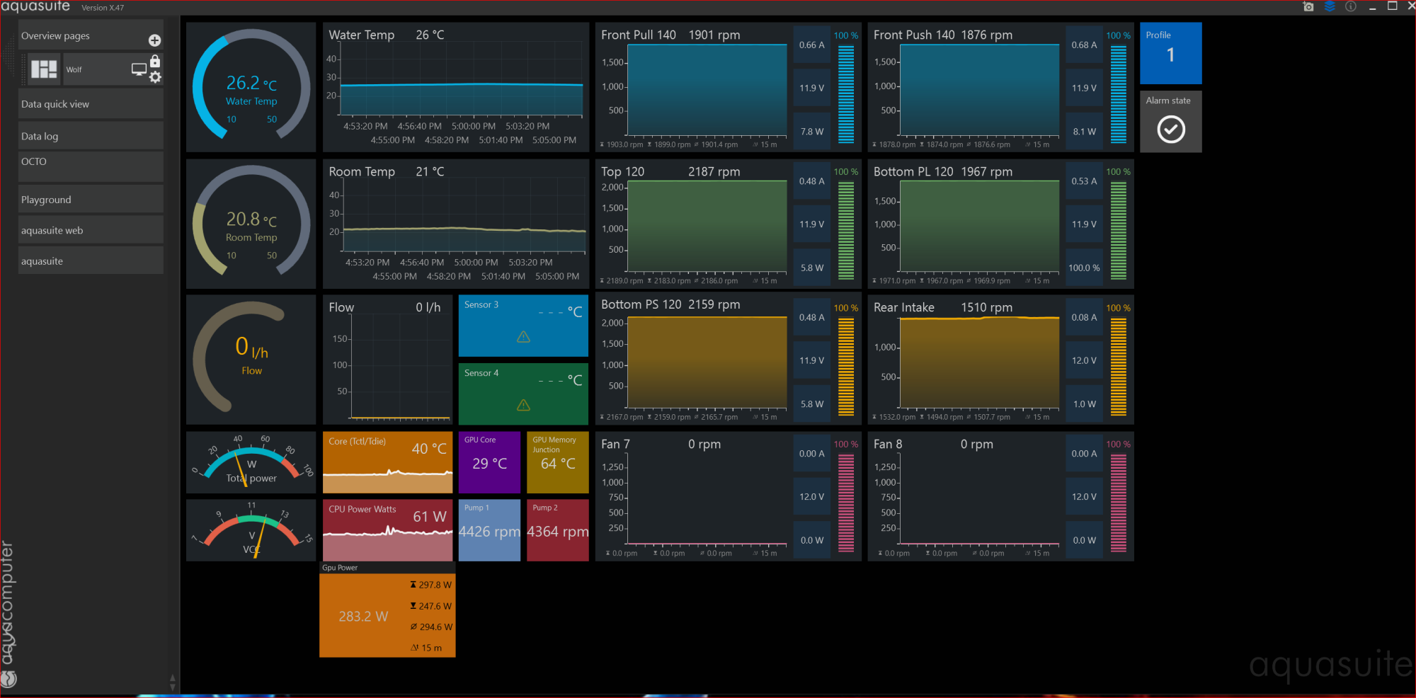

yea door is side sorry i got a pretty bad cold so minds not working correctly with little sleep i been getting. I switched to a all exhaust but 1 because my rigs mines 24/7 on the gpu and couple a hrs a day my cpu gets hammerd so tons of heat i found with front as intake and top as exhaust over time my temps were getting pretty bad water temp pushing up over 35c. I guess temps are pretty good just was seeing if anyone had a good idea for mesh and where to get it to maybe change the side into a mesh panel Heres a shot of my aquasuit last 13hrs in temps i will get a pic of the rig later dont feel like moving this 100 pound monster right now.
