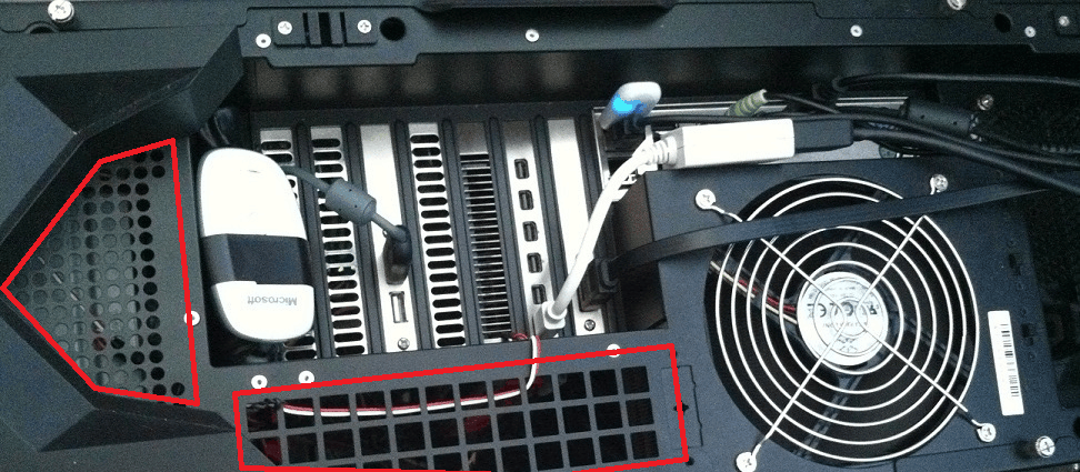

Looks pretty neat, very different design. How is the clearance on the top with DVI cables etc plugged in?
I dont get how this case will be silent. it seems like everything is plug on the top too? It looks kind of interesting but I dont get how it will make gfx card silent.

The Silverstone Fortress FT-02 Case has dampening foam on the side panels, and it's better airflow means the video card's fan does not have to run as high to compensate. The Silverstone Raven RV-02 is very-similar in design.
The RV-02 doesn't have side panel dampening foam like the FT-02.

Because the case unlike most other case's got overpressure, instead of underpressure.I dont get how this case will be silent. it seems like everything is plug on the top too? It looks kind of interesting but I dont get how it will make gfx card silent.
My friend had a similar problem whit his two 480GTX in a 800D, it was noisy!If you're going to air cool, don't go with the 800D. Get the FT02/RV02. It's the extra cost of fans and rear/top intake with no filters that makes it not a good choice.
At the same time, I won't buy a GTX 480, the heat issues with that card exceeds any cases cooling potential. 80C+ temps with the GTX 480s is just something you have to deal with.
And if i would get this case i would seriously consider taping up the vent holes, ore at least try it out what works better.
Yes, there is water cooling tube holes
http://www.hardwaresecrets.com/article/SilverStone-Raven-RV02-Case-Review/789/3
Pic, www.hardwaresecrets.com/fullimage.php?image=18462

I owned the case for a while and never noticed them lol. Though I never did build in it.
You had a Raven 2? The FT02 has the holes blocked off so you wouldn't notice them if you're going off of that.

Wouldn't those fans be at least partially restricted by being so close to the (stone!) floor, meaning that this case would cool better were it orientated 90o to the left, like a normal case :S
More pressure in the case means that the fan on the 480GTX has to work a lot less.You don't want to tape up the top vents on the FT/RV02. It already has a positive pressure design, so there's no need to create more pressure.
The 120mm above the CPU will still blow out all the hot air and i think will still be anouge to cool everything that needs cooling.Also, why would you want to block the hot air from rising out of the case?
