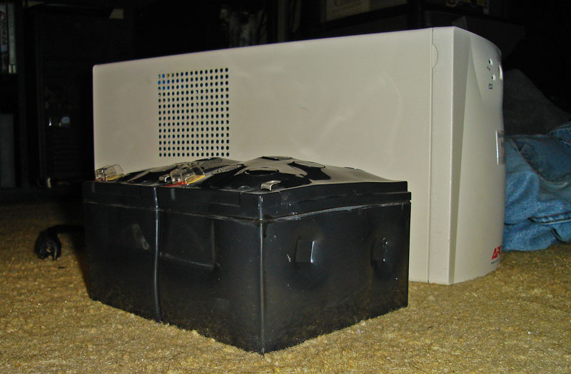

A friend gave me a faulty 5 year old APC Back Ups Pro 1000 and I contacted them asking how to diagnose the issue with it before buying new batteries.
Told them the batteries were swollen in the unit and were hard to get out and the unit would just beep and turn off when you plugged it in and hit the power button.
They asked for pics, I sent them a few, and then they asked for my mailing address and sent me a new Back Ups RS 1200.
Didn't need proof of purchase and the unit was well past the warranty too.
3 years later the UPS didn't catch a power surge or something and my D-Link switch died and they sent me a new Back Ups 1300 to replace this one, which still worked and I kept.
So I got 2 free UPS's from them and then just bought myself another APC 1300 for my gaming PC I built for the garage.

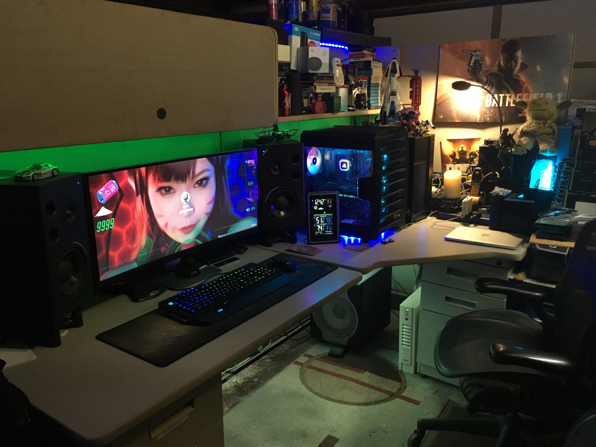

My desk,

Christ those batteries. I've seen swollen SLA batteries, but never that bad.
But this shows why you replace your batteries as scheduled maintenance in UPSes rather than wait until they die. UPSes are not smart and cannot reliably detect SLA battery faults, not even the $20,000 variants used in the enterprise. They'll keep trying to charge a long dead battery until they either kill themselves or utterly wreck the batteries. The last hospital job I worked, I saw such a $20,000 unit completely wreck 40 SLA batteries and nuke itself because it could not detect that the batteries had failed. Most were leaking badly, some had cracked and vented, others were inflated and deformed. The charging circuitry had a crater in it.
I see people argue all the time that their 4-7 year old SLA batteries are just fine because their UPS is telling them so. That's a disaster in the making. Change your batteries every two years, at most four. UPSes are really hard on them with the constant charging and heat.
I regularly buy $200-400 UPSes for pennies on the dollar because the original owner says they stopped working, or from the junk yard where they're thrown out because the batteries were never replaced and they stop working.

I went with APC since they have awesome customer service.
View attachment 243987 View attachment 243988
Seems like it would be nicer if the units didn't keep having problems so you didn't have to replace them and attached equipment.....
