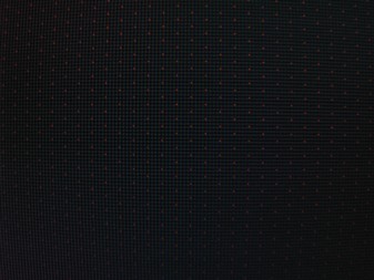

I just got a HP LP2475 (H-IPS) and yesterday I noticed an area near the bottom-right corner that has 50+ stuck red subpixels. I always use a black background but haven't seen it at first because of my poor sight.
Out of curiosity, I decided to test with more background colors, and the results were staggering: no red subpixels are lit when using blue or green backgrounds!

What's the deal here? Is this some other kind of panel defect?
P.S. red and white, just for fun
Pretty colored lights!
That's a panel defect for sure, or the panel was impacted causing the problems. Return it as fast as you can.

Holy crap, I encountered the same defect in an NEC LCD2690WUXi:
That's definitely a panel defect.
Also, since you don't see a white glow, do you see a faint red or green glow instead? Can you get a picture of a black screen at an angle in a dark room?
Wow, yours seems to have a pretty large area with those dots. Mine is about 1 square cm.
What is it with these IPS panels?
P.S. The white glow is there, it just doesn't bother me :) No red or green
Can't wait to get a new one!
I've also got a 2cm x 1cm area (l/w) filled with these red dots, and they only show with fullscreen black. They are only noticeable when you look real close. Are these bugged pixels or what? (LG w2600hp-bf S-IPS)
Did you guys get warranty?
I have a single pixel with this issue. Not sure if it falls under warranty or if it's worth replacing over. Yours, however, is definitely a defect and worth replacing for. That looks like at least ten pixels easy, so yeah, should be no problem.

I've never seen so many lit pixels... Call HP and get them to replace it.
Just curious, but how do you get those images that show the pixels so clearly?
I'm assuming super macro mode on a camera? Anyways, I have always thought dead pixels to be more of a random thing. These patterns are interesting and leads me to believe it is something related to the internal circuitry or something. There's no way all of those pixels died in such a nice pattern. :p

Here my snapshots.
With the camera it seems like 10 times worse.
It isn't really visible on the black, but the camera registers it way better then our eyes.
ps. pics made with canon ixus 70 compact camera.
That's a pretty bad red streak on the monitor. Get it replaced.
Well i went to the store's customers support and i got a completely new monitor.
It was handled as hardware malfunction rather then a pixel problem and therefore they gave me a brand new LG W2600HP-BF.
I showed them the above pics and that really helped them seeing the problem rather then testing it and waste my precious time.
Hope this new screen won't have this problem, couldn't really see anything on the new panel with the lighting at the customer support.
