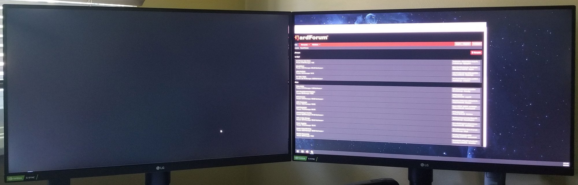

This issue is kind of hard to explain, so I'll attach a couple of pictures so you can see what I'm talking about...
My left side screen will randomly go blank and the only way to bring it back from everything I've tried is to reboot the PC. Again, this is random, but will usually last at least 12 hours before it happens after a reboot, sometimes lasting for several days before it happens. Most of the time it happens between 12 and 48 hours.
Oddly enough, the screen's backlight stays on (doesn't go to powersave mode). My mouse cursor will move on the screen as you can see in one of the pictures. If I press the "start" key on the keyboard, the start menu pops up as well as the taskbar. But if click off of the start menu, the menu goes away as well as the task bar.

That is a software issue. One of your apps is crashing to a black screen and is on top.
go to task manager next time it happens and start closing apps till you find the one that is on top.

Excellent call Zepher! It was an application I use that was causing the blackout issue.
Happened to be a mouse cursor app I use for games like D3 called YoloMouse.
