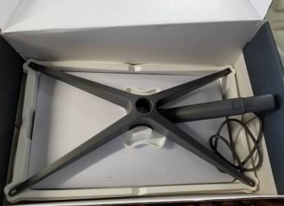

The Antenna is actually a lot smaller than I thought it would be.

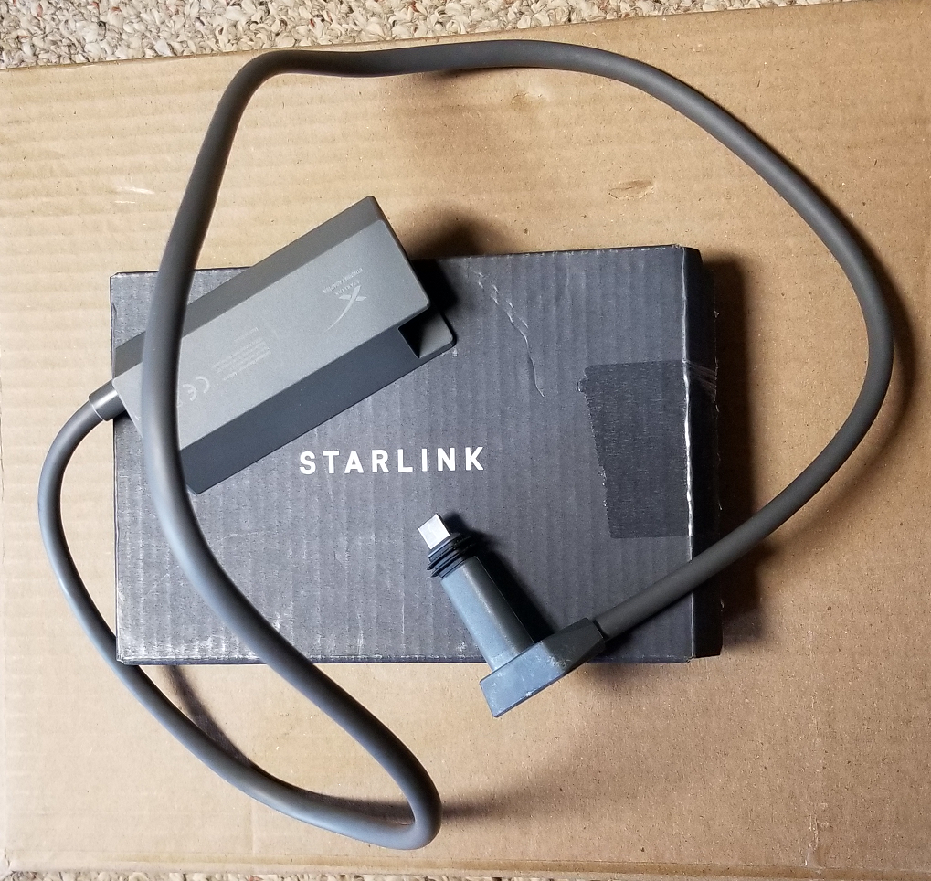

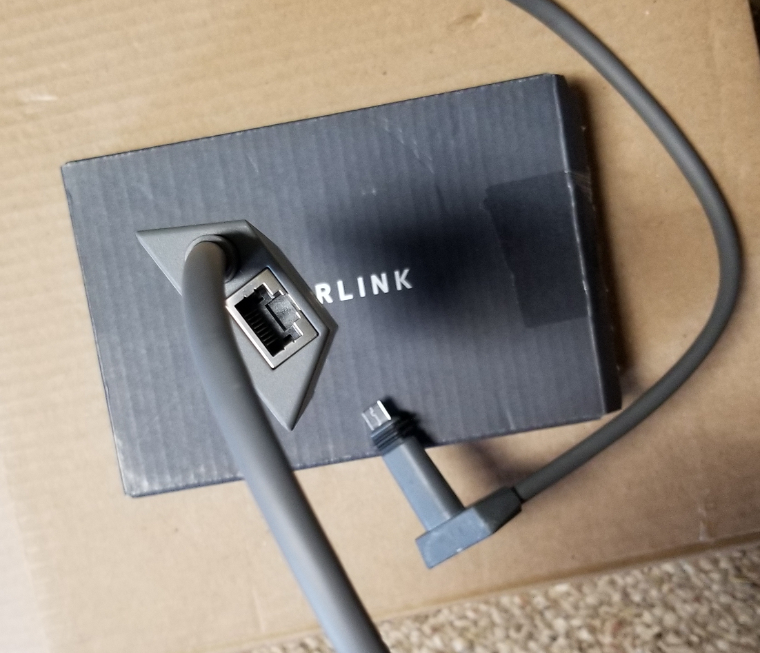

It took 3 extra weeks but the Ethernet Adapter finally showed up. It's pretty unremarkable and goes between the antenna and the Starlink router, which makes sense since that's literally the only port on the entire router aside from the power.
It was nice to get the whole house switched over finally. Using the ethernet adapter didn't change anything as far as what type of IP I got. Still CGNAT for now.
