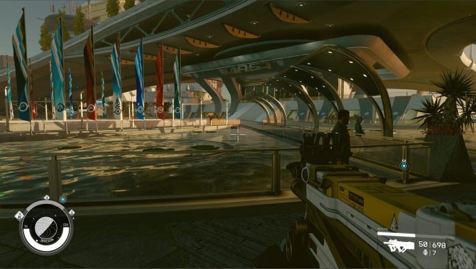

let’s examine a particular scene.
starfield_test_scene.jpgThe profiled scene
We analyzed this scene using Nvidia’s Nsight Graphics and AMD’s Radeon GPU Profiler to get some insight into why Starfield performs the way it does. On the Nvidia side, we covered the last three generations of cards by testing the RTX 4090, RTX 3090, and Titan RTX. On AMD, we tested the RX 7900 XTX. The i9-13900K was used to collect data for all of these GPUs.
We’ll be analyzing the three longest duration calls because digging through each of the ~6800 events would be impractical.
1. Longest Duration Compute Shader​
cache access latency is very high on GPUs, so higher occupancy often correlates with better utilization.
Register allocation doesn’t differ much between AMD and Nvidia, but Nvidia’s much smaller register file means its architectures can’t keep as much work in flight per SIMD lane.
The takeaway from this shader is that AMD’s RDNA 3 architecture is better set up to feed its execution units. Each SIMD has three times as much vector register file capacity as Nvidia’s Ampere, Ada, or Turing SMSPs, allowing higher occupancy.
