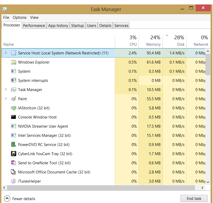

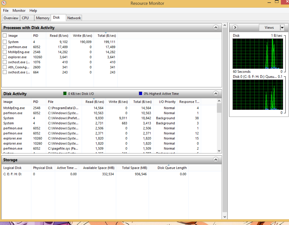

    Is there something accessing the drive in the background? Post a list of process explorer or check resource monitor under the disk section.

    Here's both
    and disk usually goes to 90 while doing some transfer. Untitled.png Untitled1.png
