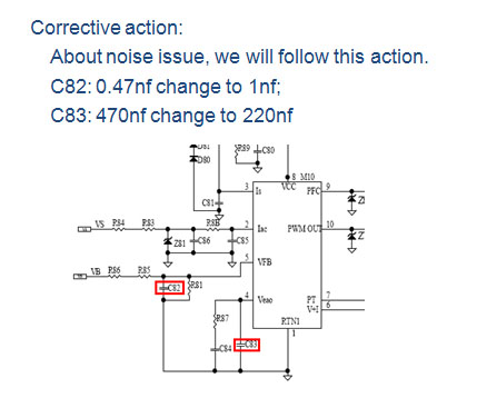

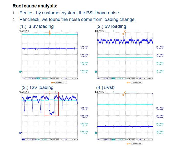

Hi everyone, I want to thank Patyrn and everyone here for patiently waiting for our test results. It took a while for us to locate the returned PSUs from the store that sold to Patyrn, test them in our US office, and then finally back here in Taiwan.
For those of you that are experiencing chirping noise from your ST45SF, please rest assure that this occurrence is not an indication of impending PSU failure. We have done tests with returned and new ST45SF units that chirp constantly for 24 hour straight with system running Prime95 & Furmark (this is the best combination to produce chirping from ST45SF). The following information will also show that noise generation is dependent on loading characteristics of the systems used.
To add to what was reported earlier, besides the Zotac Z68-ITX, we have confirmed that ASUS Rampage II Gene can also be used to generate chirping noise from ST45SF. After nearly a week of testing by the PSU engineers, they were finally able to isolate the cause and come up with counter measures. Below are snap shots from the test report:

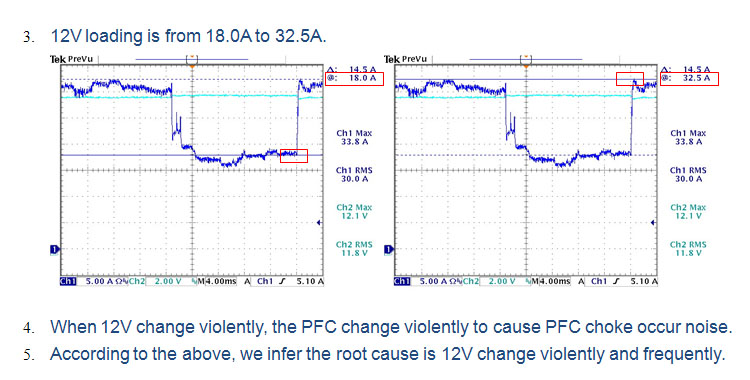

These are loading produced by the test system (ASUS Rampage II Gene) running Prime95 and Furmark. ST45SF’s chirping noise occurs in conjunction with +12V’s loading change that appears to produce a large valley on the graph above.
Zooming in on the +12V loading graph, we can see this sudden change in loading condition more clearly. Systems that do not generate chirping noise from ST45SF have milder/slower loading change.
After more testing/trial and error, the engineers were able to pin point two places where replacing capacitors with different capacitance could change the noise frequency to level undetectable by human ears.
Unfortunately this type of replacement work is not suitable for users to perform by themselves. So if you are experiencing chirping noise with your ST45SF, we will offer to replace it with revised ST45SF that we will start producing as soon as we complete their production validation. It will likely take a couple of months for our branch offices to get them to be able to distribute to everyone that need one, so please bear with us. We will have an update on ST45SF product page and I will update everyone here again when the revised ST45SF is available.
Again, I want to remind everyone that the chirping issue only happens to systems that have loading change condition I described above (high +12V dynamic loading from certain motherboards) and some ST45SF may even experience lighter symptoms as result of production variance. So if you have never experienced chirping from your current ST45SF, you have a perfectly fine PSU and no need to swap to a revised unit.
