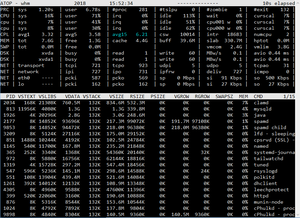

Have you tried installing atop to get a point-in-time picture of the system state for later analysis?

The t2 family is intended for low-load applications that may need occasional higher-than-baseline performance. Lots of people use t2 instances for various production purposes; lots of people also misuse them because they didn't read how the CPU credits work and/or they didn't load test before deploying. Scaling up the instance size before understanding the issue is not good advice unless it's an emergency that is costing your business more money than the increase in operational cost and you are still going to investigate the problem after the immediate production pain has been taken care of. It sounds to me as though you are not sure why the load is high and so you should investigate the root cause first.
Are you exhausting the instance's CPU credits (sounds like "no", but please do confirm) or is burst rate simply not providing enough CPU to keep up with requests? Review your EC2 CloudWatch metrics.
I presume the DB is running on-instance rather than in RDS? Have you verified you're not IO bound when at peak load? You didn't mention it, but it's likely the instance is using a gp2 volume whose performance is modeled using baseline rate with a burst bucket. Check for high iowait ("wa" in top) and review your CloudWatch EBS metrics.
Thank you for your help. However the problem is I am not a linux administrator. And can do basic monitoring only.
As of now I am not running out of credits because a good number of credits have accumulated during the weekend and my t2 large has a cap of 850 credits. Approx 200-250 credits are used during business hours and credits are updated at night when volume is low. The problem is that of optimization. My site runs on cms codeigniter, more content and stuff reside in db and are read from there. However the biggest db maybe 200 mb in size and other db are small. Inspite of this the site runs slow because they were just dumped into the server with basic tweaking only. I have a CSF and ClamAV.
Atop is not installed so far and DB is running on the same instance. Have you verified you're not IO bound when at peak load? - I don't know plus have no idea how to check.
I just installed atop and am attaching 4 images. Let me know what you think.
https://preview.************/idzLEG/atop.png
https://preview.************/cD9bob/atop2.png
https://preview.************/gNb0EG/atop3.png
https://preview.************/bUAhTb/atop4.png

The issue has been sorted for now. The guy who developed website was inserting a record in a db table to manage sessions. He did not delete those temp records and it crossed the 1 million mark. This made the site slow. Once I deleted the records the site became fast.

1) After asking few people and doing my bit I figured that mysql was hogging all the resources. This caused CPU credits exhaustion.
2) I upgraded my server to t2 large but the feedback I got on this thread indicated there is another problem and server upgrade is not the solution
3) I started to examine mysql threads/queries and found out that a query from a particular table took longer than expected.
4) I found out that the table held session related record and had temporary records. It has over a million records.
5) The idiot who developed the site didn't tell me about it nor he wrote query to delete the records
The deletion of those records fixed the site and its working fine now. Getting work done here is not easy and very few companies do quality work. Plus its difficult to determine which one does.

Thank you for your feedback. However you have to understand that my work is small and i do not have the time to learn aws in depth. If i start doing that then i wont be able to do other ten things that i do.
However i managed to fix the cpu load. As mentioned in post earlier the issue is fixed for now.
B00nie
Nov 1, 2012
9,327
If you have a 160Mb dataset, tweak your mysql setting by increasing your buffer pool size to larger than 160mb instead of the default 8. This will load your entire data to memory inside mysql. Then if you have a relatively static dataset you can enable mysql query cache which will speed up your queries by orders of magnitude if your data is relatively static stock data for example.
Further speed up can be achieved by enabling compression and headers/expires in Apache so static content is cached client side and that relieves a lot of work from your server.
