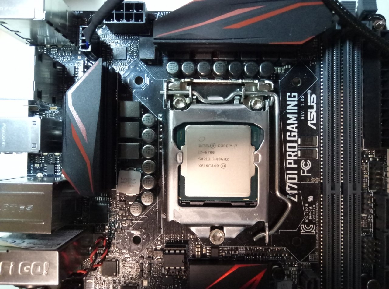

Just to clarify things about C7 because I'm not so sure that You can get a lot of motherboards not having this possible issue:
The area marked by red tint touches the motherboard in this orientation and When mounting you simply cannot be sure whether the screws are properly tightened or not in this orientation.

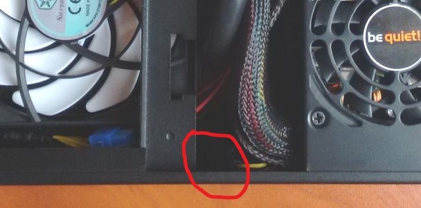

Hi, guys!
I'm waiting for the sentry almost a year so I recently decided to start my build without the case and purchased all parts except video card. As you can see on the photo, I have mini-itx asus z170i pro gaming motherboard with huge solid caps near socket. C7 cooler fits nice to this board without any problems except backplate. Impossible to mount it due to interface with smd components on the pcb hence I have to use washers.
Do any of the 2.5" bays support 15mm drives?
With short GPU, or with one that has blower that is thinner than the rest of the card You should be able to mount 15mm drive in the bottom of GPU compartment. With quad 2.5" bracket You should be able to use 3 of them (one upside down) along with up to 200mm GPU.
The bigger problem here would be the fact that the motherboard may have the connector for those drives facing outward and You might not fit the plug because of the power supply proximity.
