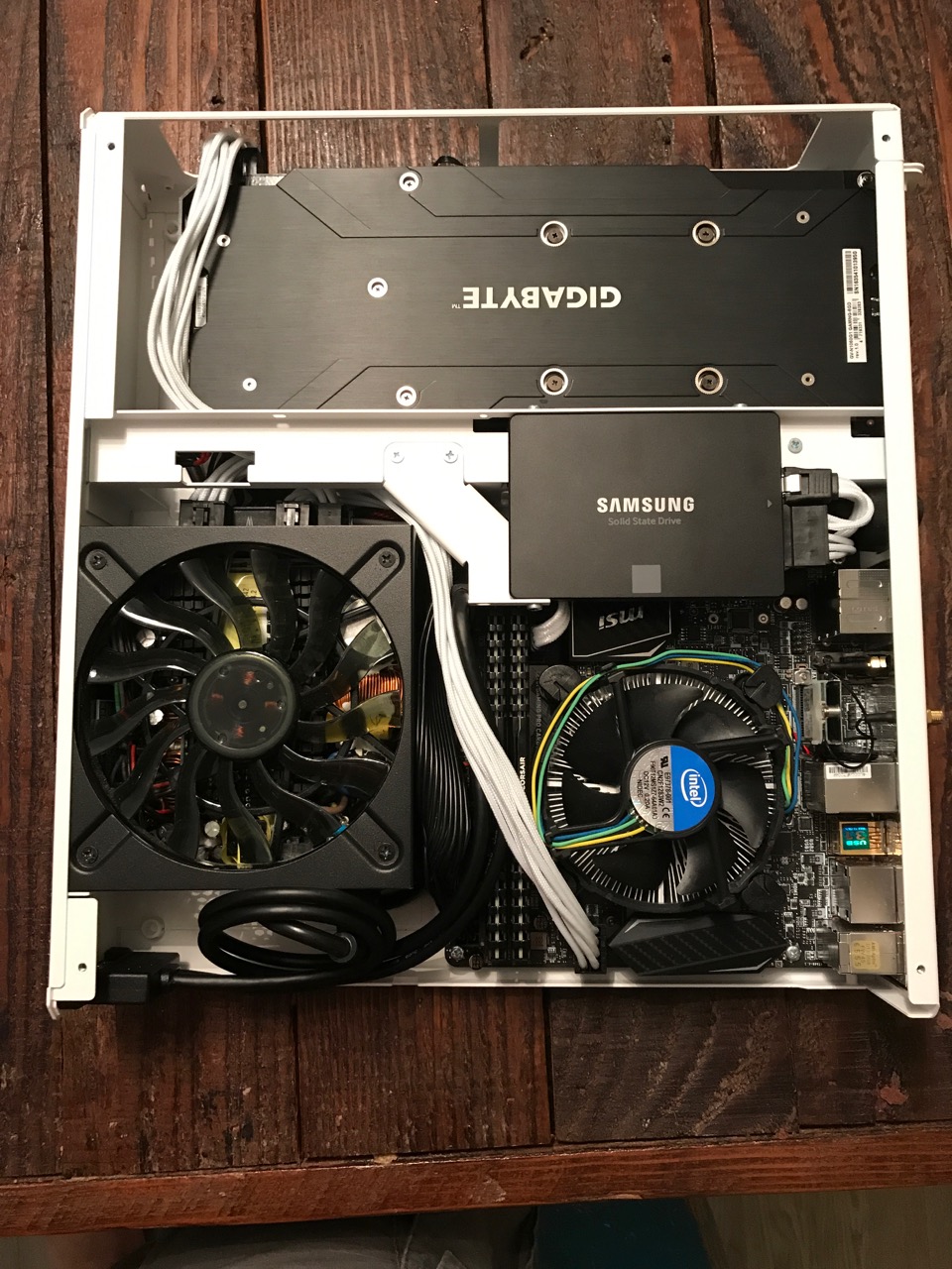

...AAAAaaaand my 24 pin Cablemod power cable is too short :arghh:
Looks like 250mm is just a hair too short for my setup. Darn. I'm not about to shell out another $59.90 for another one shipped, so I'll be stuffing my stock cable back in (bummer).
That said, it's all assembled!

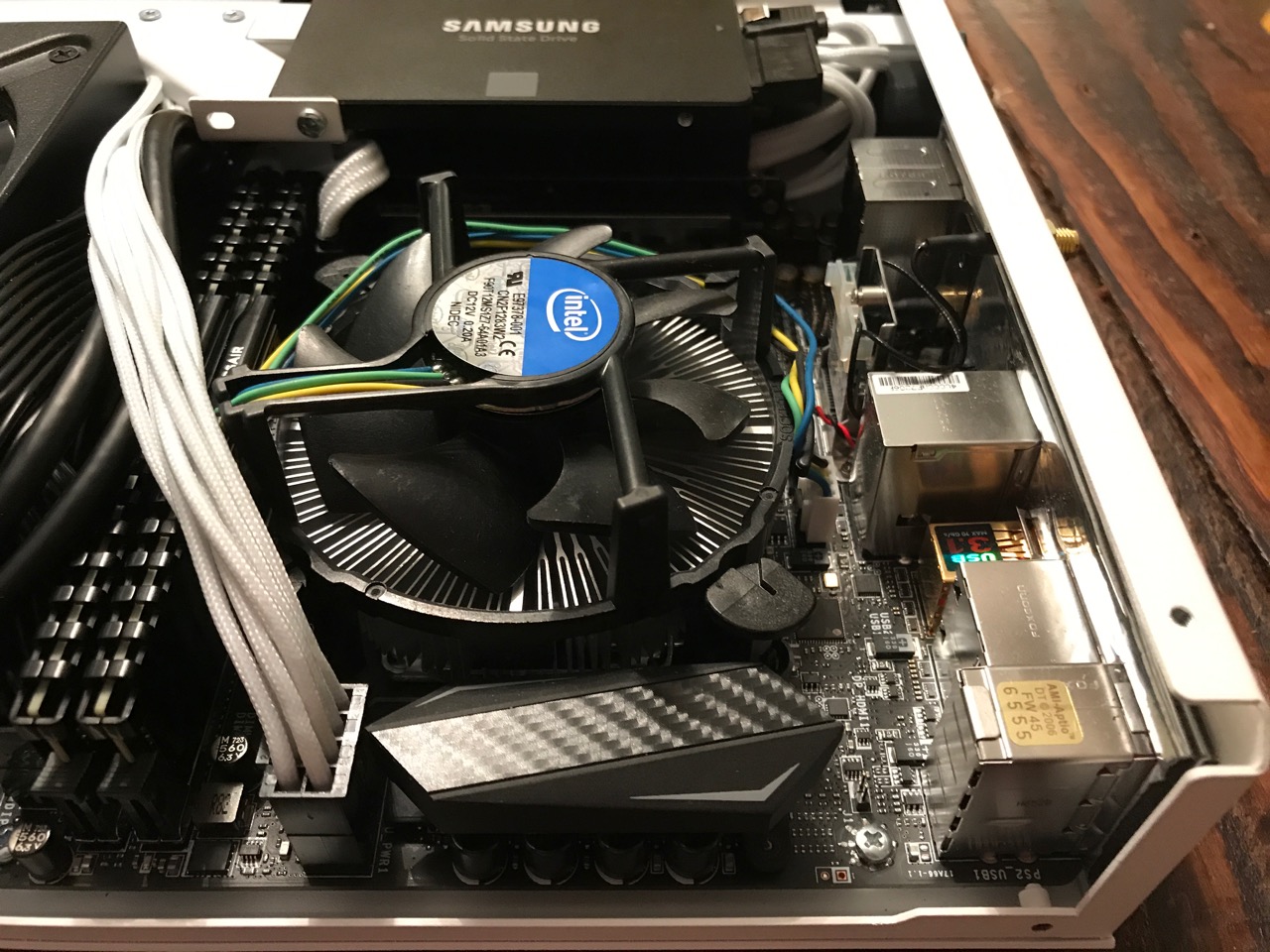

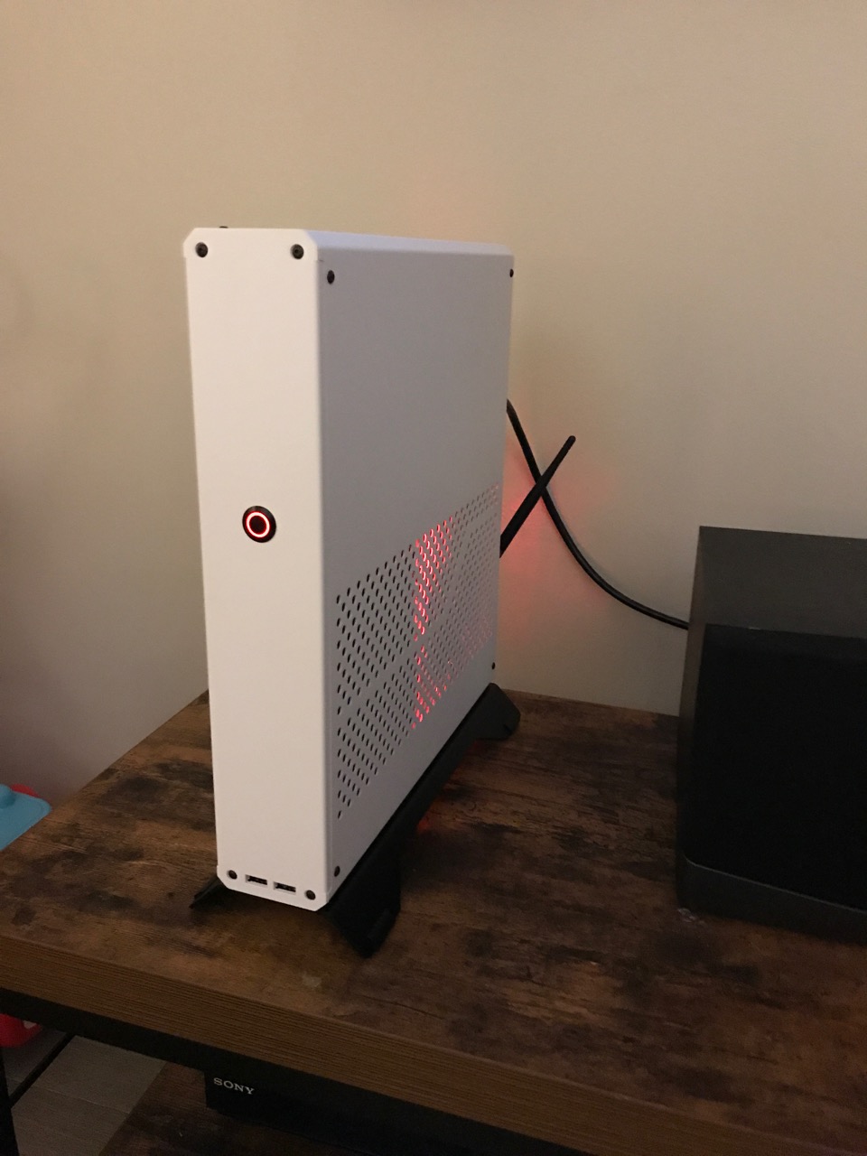

One last update on mine for the night, it's alive!!!
I have noticed that with this case I notice a bit more noise from the PSU fan than I did in the RVZ02. It was dead silent before. Not a big deal and I figure it's due to the fan being right against the side of the case. I don't mind the slight noise though, I only notice it within 3 feet or so.
I will say, the Cablemod cables definitely helped (I wish my 24 pin worked out for me, oh well). So far so good, and I'm LOVING the difference in how much smaller it is than the RVZ02 it replaced, not to mention how much more solid it is!
Recap on my setup:
MSI Z270i Pro Carbon
Intel Core i5 7500T 35W TDP CPU with copper core Intel cooler off a 95W TDP CPU
Corsair Vengeance 16GB RAM
500 GB M.2 SATA plus 250 GB 2.5" SSD
Silverstone SX500LG SFX-L PSU
GIGABYTE GTX 1060 G1 GAMING-6GD

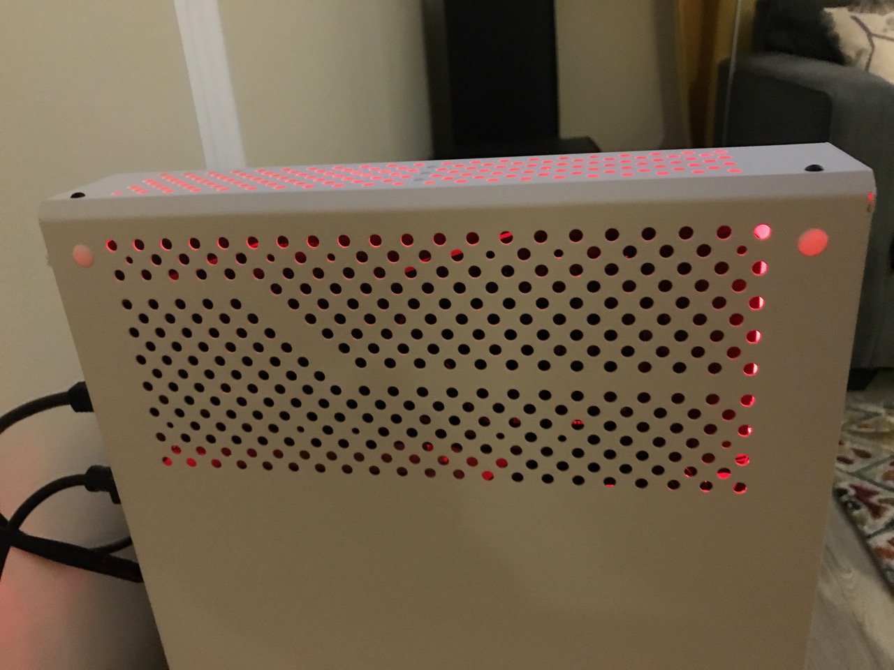

I "may" have gone a little on the LED side of things, though I'm pleased with the results!
I ran an adhesive RGB LED strip around the case just for fun, goes well with the MSI motherboard. Gigabyte GPU also has RGB lighting on top, so it is nicely coordinated.
Bad quality iPhone pic:

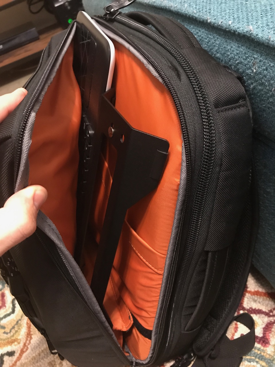

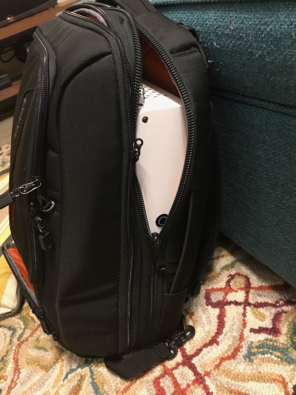

One last bonus: It's tight but the Sentry fits in my choice of bag, the eBags Professional Slim Laptop Backpack.
Plenty of vertical room here, where it's tight is in the lateral room.
Zips snugly
Even room in the front compartment for stand and small keyboard! (cords fit below in AC adapter garage).
I'm very pleased with this and ready to take my Sentry on travel!
Zips snugly
Thanks again to the Sentry team for making this possible!

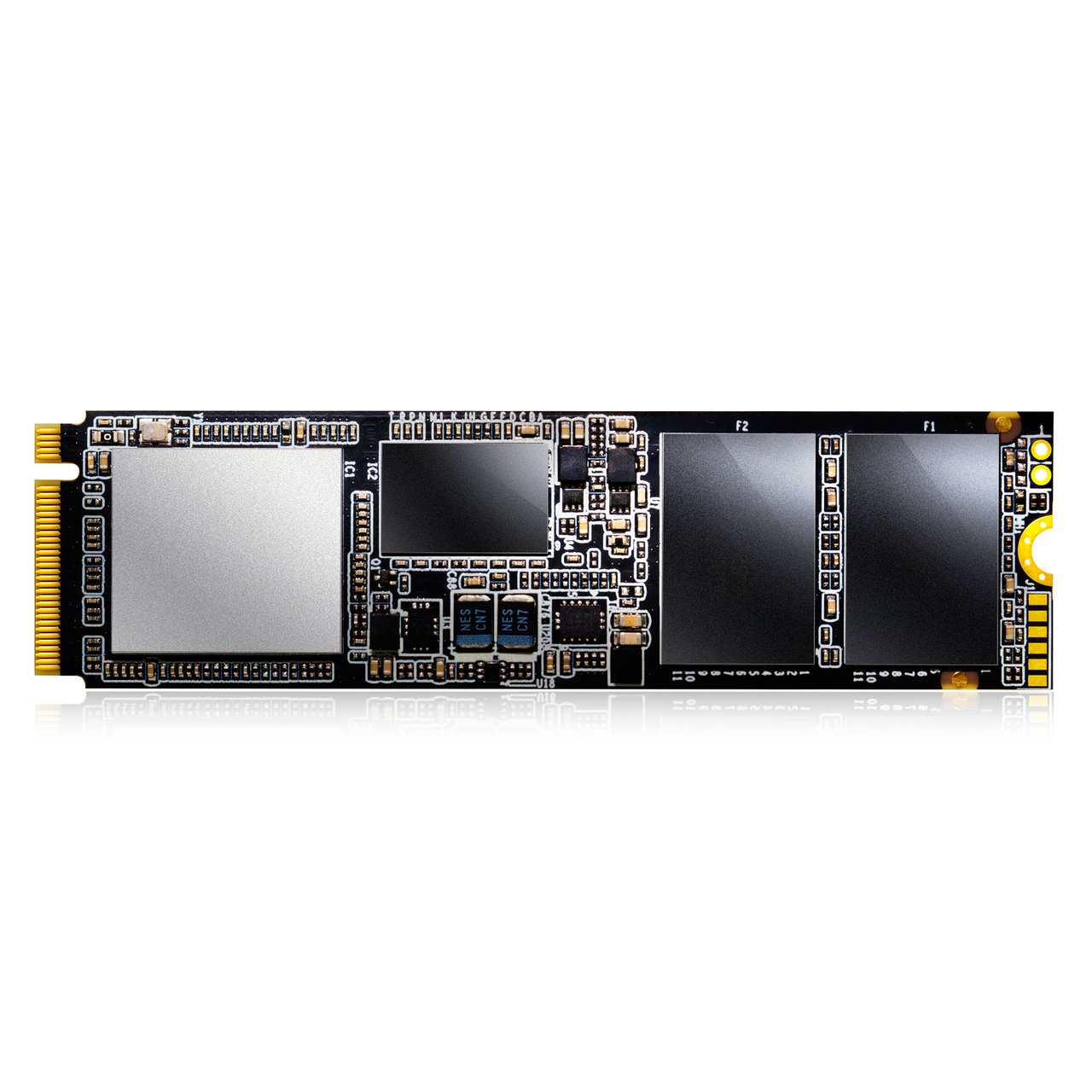

Adata has just released an industrial grade M.2 NVME ssd that can handle Industrial-grade extended temperature range of -40°C to 90°C
Do you think it is a good idea to try it in the Sentry ? since it can handle that much heat (in the back if the motherboard)

This is really interesting. I like Guru3D's overview and it sounds like the increased temperature range and shock resistance are built for use-cases like the Sentry: http://www.guru3d.com/news-story/adata-adss-industrial-grade-im2p3388-pcie-m-2-nvme-ssd.html
Nice find! Now to have them finish so we can figure out the price!
We need to send an email to adata to check the price and the availability
Note that in the data sheet you have 2 part numbers:
Commercial: -10°C to 80°C
Industrial: -40°C to 90°C

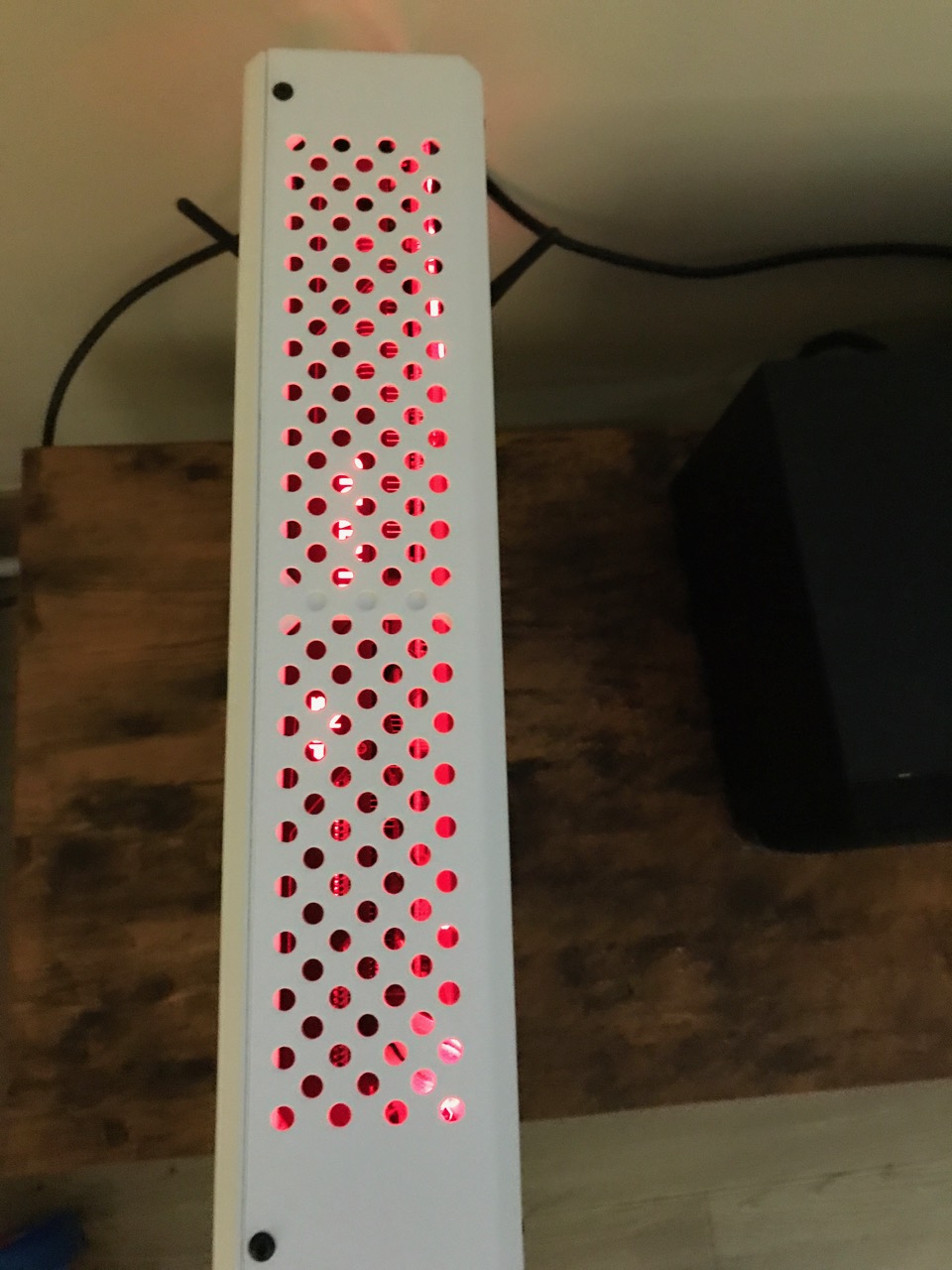

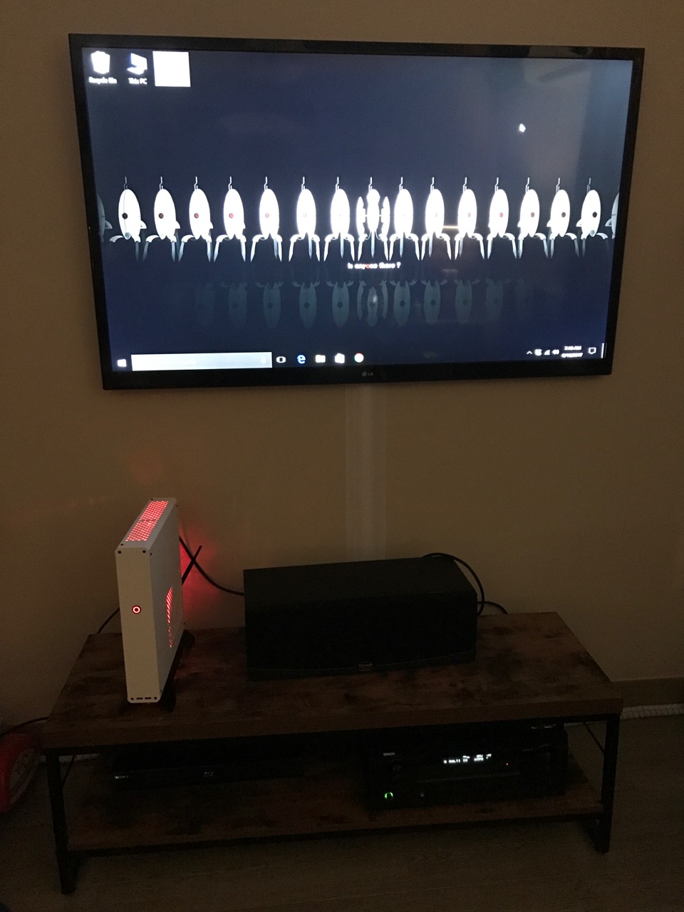

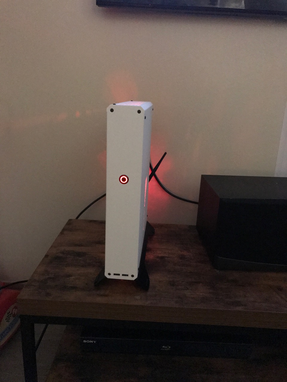

I received my Sentry in the mail on Tuesday!! It is amazing! I'm in New Hampshire in the US. I don't have all of the parts for the build though. The only things I'm need now are the ASRock Mini ITX Ryzen Motherboard, an NVME SSD, and a GPU. I'm going to be gaming in 4K playing Desstiny 2, ultra modded Bethesda games, and Assassin's Creed Origins. Will a GTX 1080 be enough for that, our should I get a 1080 Ti? I am aware that the 1080 Ti is not recommended based on TDP for the Sentry, but am curious on the opinion of others.
I would probably go with the Ti for that lineup at 4k, honestly. Especially with the mods, it's going to be punishing.
I don't recall if it has been confirmed to fit in the Sentry, but the EVGA FTW3 1080ti seemed to have nearly the best thermals.
Unfortunately it won't fit, it's far too tall.- almost 143mm and the connectors are not receded into the PCB so there's no leeway. It would leave less than 2mm of space where you wouldn't be able to squeeze in a connector (even low profile/angled).
