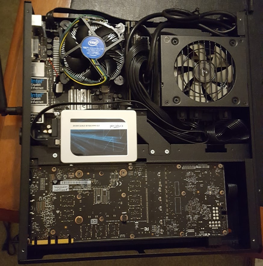

After assembly just before the cover goes back on -
I installed windows and played a bit of the new Tomb Raider. Very pleased with everything so far!!!
Thanks to Dr. Zaber and all involved for a great product that was exactly what I was looking for in a small form factor case. Finally, my very own steam box :)

US buyer from Wisconsin. I got my sentry and all the components yesterday, everything arrived on the same day!
This was my first time building in a case of such size and it was harder than I expected, but not too bad overall.
Love the case, very premium feel to it.
Challenges:
1) The pci extender install was CONFUSING! I had to watch Dr. Zabers youtube install video and pause and see exactly where the extender was supposed to line up, I wasn't sure if the 2 screws where supposed to screw thru the riser itself or just keep it in place, its the later.
2)The corsair 450 sfx psu wouldn't fit flush against the front of the case. This was due to the power slot overlapping the bracket by just a hair, this wasn't a big deal, I debated dremeling the power connector, but just kept it as is. I was still able to secure it with the screws just fine.
The only other challenging part was cable management, but once i figured out what worked and what didn't it came together just fine.
IMPORTANT NOTE: If you plan to go with the stock cooler bundled with a Core i7 you will not be happy, it cools fine but it is very loud. I just purchased a Cyorig C7 so hopefully that is quieter.
Parts List:
CPU: Intel - Core i7-7700 3.6GHz Quad-Core Processor
Motherboard: ASRock - H270M-ITX/ac Mini ITX LGA1151 Motherboard
Memory: G.Skill - Aegis 32GB (2 x 16GB) DDR4-2400 Memory
Storage: Samsung - 960 EVO 250GB M.2-2280 Solid State Drive
Storage: Crucial - MX300 1.1TB 2.5" Solid State Drive
Video Card: EVGA - GeForce GTX 1080 8GB Video Card
Power Supply: Corsair - SF 450W 80+ Gold Certified Fully-Modular SFX Power Supply
Other: Dr. Zaber Sentry
Some pictures:
Before assembly -

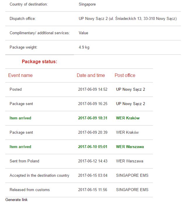

Just want to update, shipping to Singapore is very fast - it took only 1 week to get delivered to my place
Package status:
Event name Date and time Post office
Posted 2017-06-09 14:52 UP Nowy Sącz 2
Package sent 2017-06-09 16:25 UP Nowy Sącz 2
Item arrived 2017-06-09 18:31 WER Kraków
Package sent 2017-06-09 20:39 WER Kraków
Item arrived 2017-06-10 05:01 WER Warszawa
Sent from Poland 2017-06-12 14:43 WER Warszawa
Accepted in the destination country 2017-06-15 03:04 SINGAPORE EMS
Released from customs 2017-06-15 11:56 SINGAPORE EMS
The bad news are I am on Biz trip and cannot start the build yet
