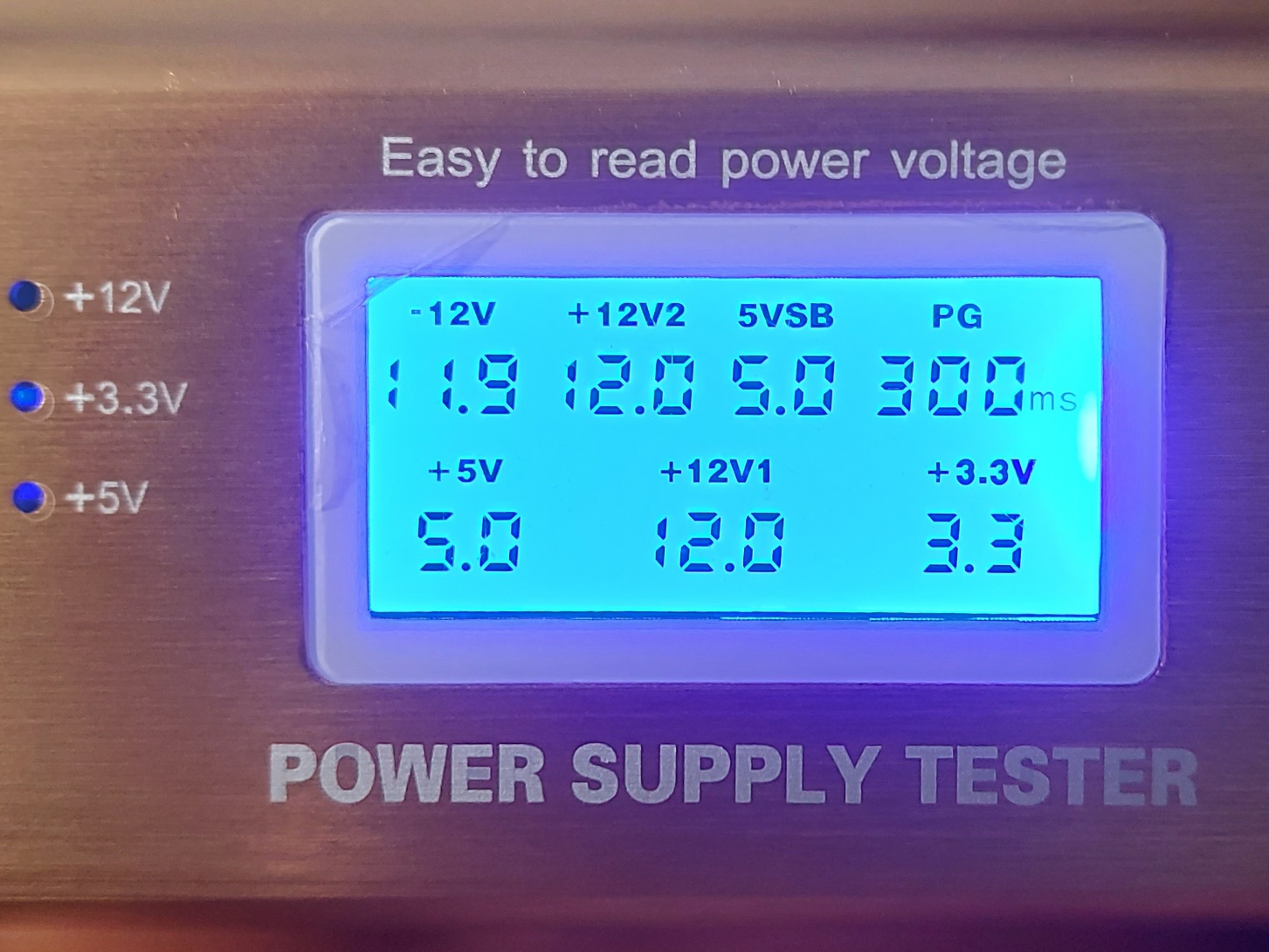

Hello,
I have semi-modular Corsair power supply and this is the tester I have bought:
Right now only 24-pin power cable is disconnected from motherboard. All the other power cables, except floppy are connected.
I want to test 24-pin cable but am concerned whether I should disconnect all the other power cables from motherboard.
I thought when PSU is switched on, all the other power cables are powered on as well and it's better to disconnect them from motherboard as well.

Those chinsey "PSU Testers" are a joke. They'll only tell you what the voltage of the PSU is in an unloaded state, nothing more, and that's nowhere near a PSU test.
They don't do load testing or ripple testing, they're effectively useless. Money would be better spent on a good multimeter.

I also tried wiggling cable after connecting it to chinese PSU tester but all readings were normal.
