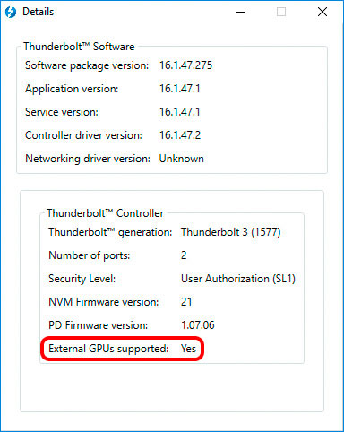

Yes I’ve done that and have the Thunderbolt icon on my desk top but can’t seem to find the app which I assume gives you the info posted above.

O.K., finally found some of those windows but they are under the carot ^ menu...shows you how little I know about this stuff.
This:
This:
and I guess I am sunk, this, ...a big fat NO...
