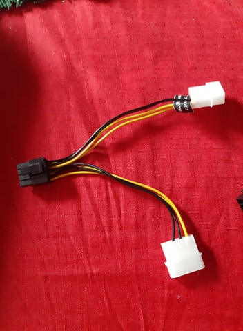

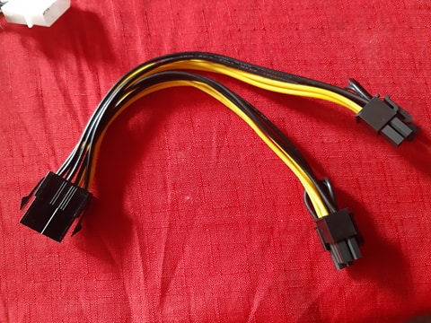

i bought 2 sets of adaptors, 1 molex to 8 pin and a adaptor that converts my 8 pin to 2x 6+2 pin.... and not 1 of them works. so i have no idea... the PSU i have is a CIT builder 700w. thanks.

why?! get a molex to 6 pin. or i guess since you got it, connect it to the 8pin and use the pus 6pin(take the two pins off).
edi: cancel that. that is a scam psu like described above*. there is no way a 700w psu is $25. get a new proper, brand name psu befor you kill your gpu.
https://www.amazon.co.uk/CiT-700W-E...0829G8TRX/ref=cm_cr_arp_d_product_top?ie=UTF8
*edit: might be confusing another thread. its a low watt psu thats been over rated.
