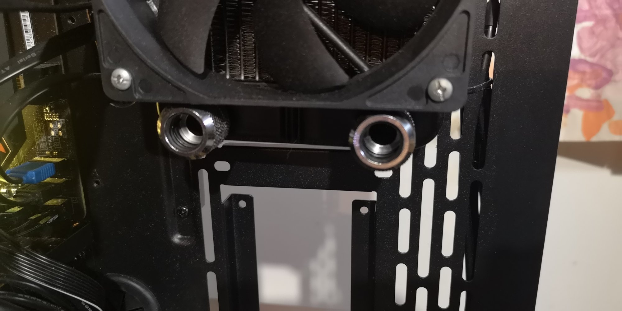

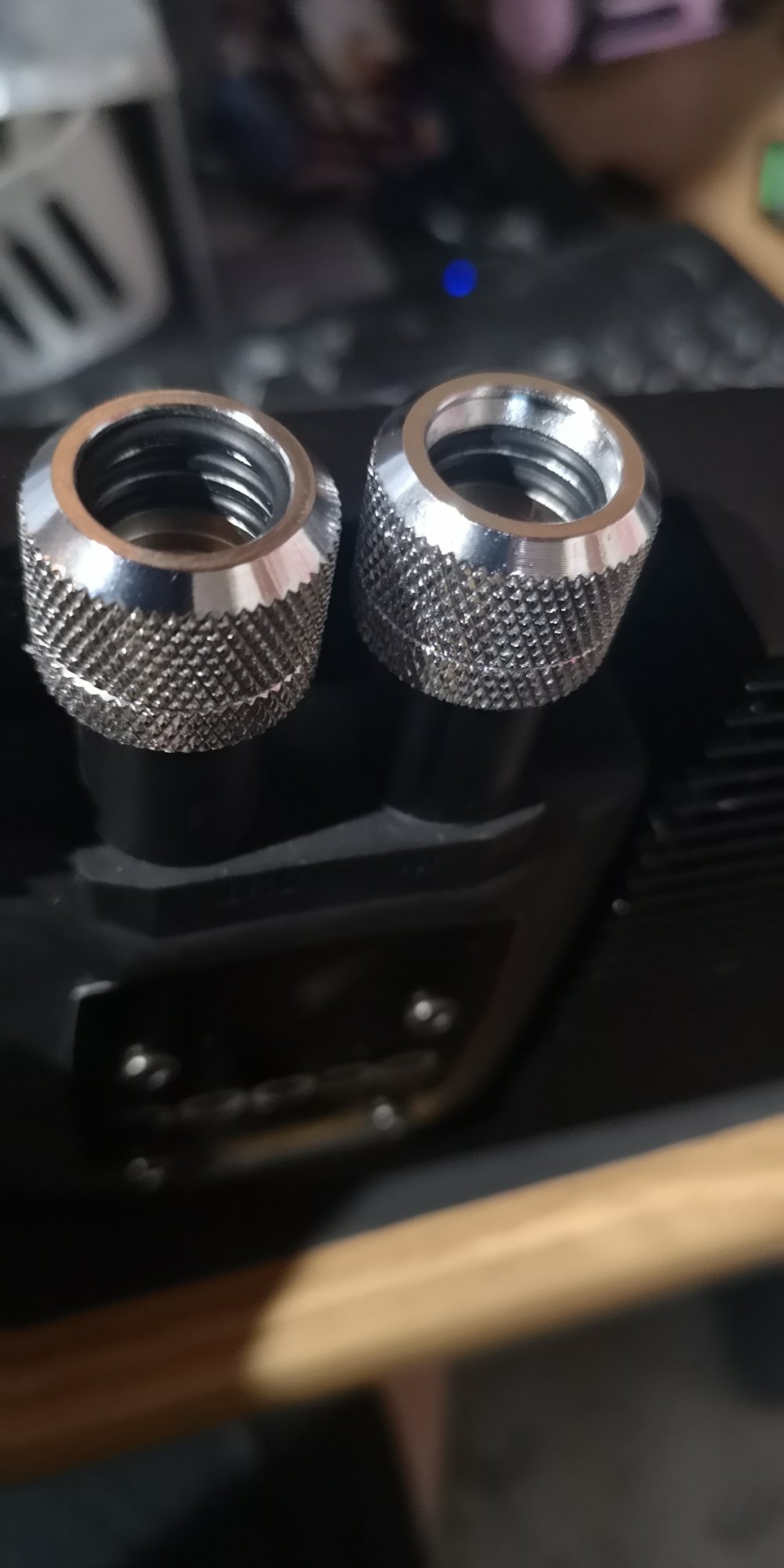

Here are some pictures of the fittings.. both the rad and block have the same fittings. Someone local said I would need hard lines for this type of fitting but I know NOTHING about this aspect of PC building. Help!
yeah those are hard line fittings. just get some cheap barbs, a pump and small res.
Alright, this is becoming painful. So, I originally ordered some 1/2 barbed fittings. Turns out almost everything is 3/8. So, I now have some 3/8 fittings, clamps, pump and hose in my cart.... But all the reservoirs say 1/4?

well you need g1/4 thread and then a barb size to match tubing, could be 1/2 or 3/8. what did you order?

1/4” npt is standard for everything, so the part that screws into the block or into the rad or pump is all 1/4 npt
also make sure you get a radiator… I don’t see you mentioning one. Even a small cheap 120 will work. Also try to have like metals (if block is copper get a copper rad)
