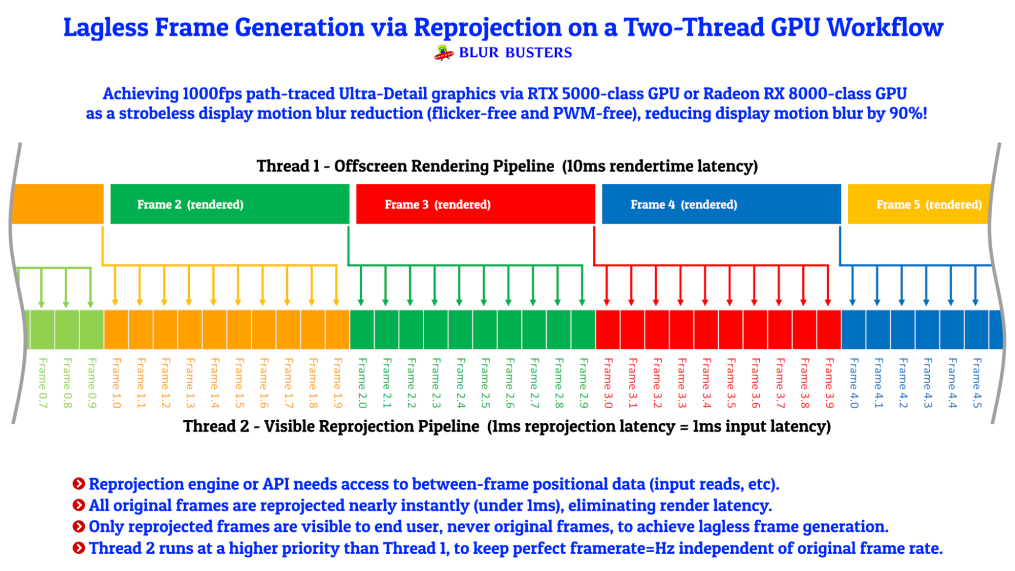

Since 1000Hz displays aren't too far off -- they will possibly be out (very approximately) by the time of the next GPU generation. 10:1 frame gen 100fps -> 1000fps, in a lagless manner.
I welcome AMD and NVIDIA to race each other to this. Even this will benefit today's 240Hz+ displays too.
(Even Intel can jump in this pool too, the water's fine!)
Since FSR / DLSS / XeSS all require game engine integration, this is an opportunity to reduce latency of frame gen by incorporating between-frame input reads. Design the API properly for that!
I hope they'll listen, Chief :D
That's why William (new writer) and I co-wrote an article.
There are hundreds of AMD & NVIDIA employees who are fans/followers, so hopefully I (and other advocates like LTT helping prod things along), help tip a few dominoes.
The question is now probably simply "when?" (which GPU generation).
I'm actually very tired of the frame rate incrementalism -- the worthlessness (to most outside esports) of small refresh rate differences such as 240-vs-360 as an example. 240Hz vs 360Hz is only a 1.1x motion blur difference due to slow GtG and high-frequency jitter adding extra motion blur (like fast-vibrating music string).
In this diminishing curve of returns, we need dramatic geometric upgrades in frame rates (60 -> 144 -> 360 -> 1000) since geometrics + "0ms GtG" are more gigantically visible to casual gamers, far beyond just esports. 240-vs-1000 is more visible to grandma than 144-vs-240, it's all about geometric multiples (as long as GtG=0) and fast motion content. We need to VHS-vs-8K this bleep, not 720p-vs-1080p, but in the temporal direction (framerate=Hz).
Adding reprojection to FSR/XeSS/DLSS/whatever/etc will be able to unlock massively more rapid frame rate progress, to allow us to replace eye-straining (to many) PWM-based strobe backlights, with ergonomic strobeless framerate-based motion blur reduction. But doubling frame rate and Hz only halves display motion blur, and only if GtG=0.

AMD's documentation on frame generation says it only functions when the base render rate is at or exceeds 60fps.
That's probably very fair, since frame generation artifacts are really nasty for sub-60fps material. Most frame generation artifacts majorly diminish (depending on the quality of algorithm) when frame rates are above the flicker fusion threshold.
Certain kinds of "distort-undistort artifacts" like parallax reveals that flicker at 30Hz (from converting 30fps to 60fps) are rather nasty -- so sometimes it's best to enforce a minimum frame rate for framegen. This hides a TON of parallax-reveal glitches in any framegen tech, including in my tests of the 1000fps-capable reprojection demo linked from the article!
Improved AI-based realtime infilling for between-frame parallax reveals (like a simple version of realtime Stable Diffusion on those few specific pixels) can lower the frame rate threshold where you see artifacts. But, surprisingly, on fast-bandwidth GPUs (like latest AMD and NVIDIA GPUs), it is it's processing-cheaper to do simple reprojection of 100fps -> 500fps, than to use expensive interpolation algorithms to convert 50fps -> 100fps.
The compute overhead of the reprojection demo is, absurdly shocking low per reprojected frame! Brute-framerating those artifacts out is sometimes.... cheaper processing. Surprisingly. But fixing artifacts with cheap framegen requires extremely high starting frame rates, such as >100fps.
But I have a suggestion to AMD. Framegen should still temporarily work for a few moments during sub-100fps or even sub-60fps to "cover the brief dips" (e.g. texture streaming disk access stutters and shader compiler stutters). Advanced users should be able to override and permit somewhat lower (e.g. 48 or 50fps) thresholds, with a warning of much more visible artifacts. Artifacts might briefly flicker in-and-out, but that can be preferable to many over a stutter. So there probably should be a deadreckoning coast in the framegen for one-time stutters.
This is why the chapter "Developer Best Practices" for lagless reprojection-based frame generation (halfway down the new article, I'll let someone else link it), recommend a starting frame rate of minimum 100fps for frame generation. Thus, good-looking 1000fps will require a base frame rate of at least 100fps (ish).

Framegen can go lagless, if integrated into engine -- far less latency than 60 native.
(...Spoiler: The truth is that it is actually lag-REDUCING!...)
FSR / XeSS / DLSS performs best if integrated into the engine, and this is just an "engine integration" improvement to include between-frame positionals.
(Above infographic is taken from the article published yesterday)
This can simultaneously perform the duty of say (DLSS + GSYNC + ULMB + PWM-Free + Lag-Free) combined.
Acts like DLSS, because reprojection warping is also frame generation.
Acts like GSYNC, because some reprojection algorithms can convert varying framerate to stutterless framerate=Hz
Acts like ULMB, because large-multiplier reprojection can eliminate motion blur strobelessly on brute-Hz displays.
Acts like PWM-Free, because reprojection works on sample and hold, no need for strobe backlight.
Acts like Lag-Free, because reprojection can undo rendering latency, as per above diagram.
Even object-aggregates (a hitbox worth of 3D geometry) such as enemy positionals are reprojectable in some more advanced reprojection algorithms, so you can fix the key lag locals and remotes. It's not just mouselook lag that is fixable. AI/neurals can help with the parallax-reveal infilling, but keeping originating frame rate (pre-reprojection) above flicker fusion threshold, hides a hell of a lot of framegen artifacts, and there are no reprojection double-images (unlike VR) when reprojecting on sample and hold.
This esports framegen is a potential Holy Grail, if can be done artifactlessly enough.
Bender would do a Fry "Take My Money!" and say "Bite My Shiny Metal Holy Grail!".

I have no doubt it could be a very good approach if done at a low level and not as a bolt on after market mod.
It’s painfully obvious that rasterization speeds aren’t keeping pace with the demands placed on them so something needs to change.
FSR3 though is going to be driver level as is DLSS3, DLSS might be hardware accelerated but it’s still a CUDA library.
I’m sure that next generation engines will integrate it at a low level, but we’re not even at the current generation of engines. So it’s probably going to be a while before the industry can make good use of it, once Microsoft and Kronos have it built in as a core function of their respective graphics APIs developers can start to make a move but until then we wait.
Yes, it will take time.
It's a long term goal, and now a new prime goal of this decade's existence for my business.
It's fantastically important to the point that I'm eagerly wanting to spend Blur Busters earnings on this.
Making reality "ergonomic flicker-free display motion blur reduction" has now become now a Blur Busters "2020-2029" Prime Directive to make it happen by year 2030 (e.g. tipping dominoes + advocacy + engine tweaks and/or Vulkan API tweaks and/or convince GPU vendors / etc). I'm open to ideas on how to incubate certain enabler technologies, but you'll have to contact me off [H].
With 240Hz OLEDs being particularly effective in showing blur-reducing frame generation benefits, the early era has arrived today. The latest RTX can do 3x-4x framegen ratios, enough to reduce display motion blur by ~3x-4x on 240Hz OLEDs, not bottlenecked by LCD GtG. In reality, it's more like 2x-2.5x due to slight extra DLSS "blur" added (some people hate this), but you get the idea -- brute multipliers is the cat's beans.
Personally, after what I've seen in labs, I'm tired of the frame rate and refresh rate incrementalism. Diminishing curve requires 4x-8x differentials now to wow properly.
I also eagerly really want to putting the industry on notice that I expect the industry to target 8x on UE5-type content by mid-decade. An 8x multiplier with only extremely faint artifacts, would be fewer artifacts than reducing detail to PONG (to achieve the same frame rate via detail-reducing means). Or the flicker/stroboscopic/darkening artifact of a strobe backlight. We can say goodbye to that with massive-ratio framegen on ultra-high-Hz displays. The motion quality finally can be made to massively outweigh the visual costs of the frame generation tech -- and do so laglessly.
