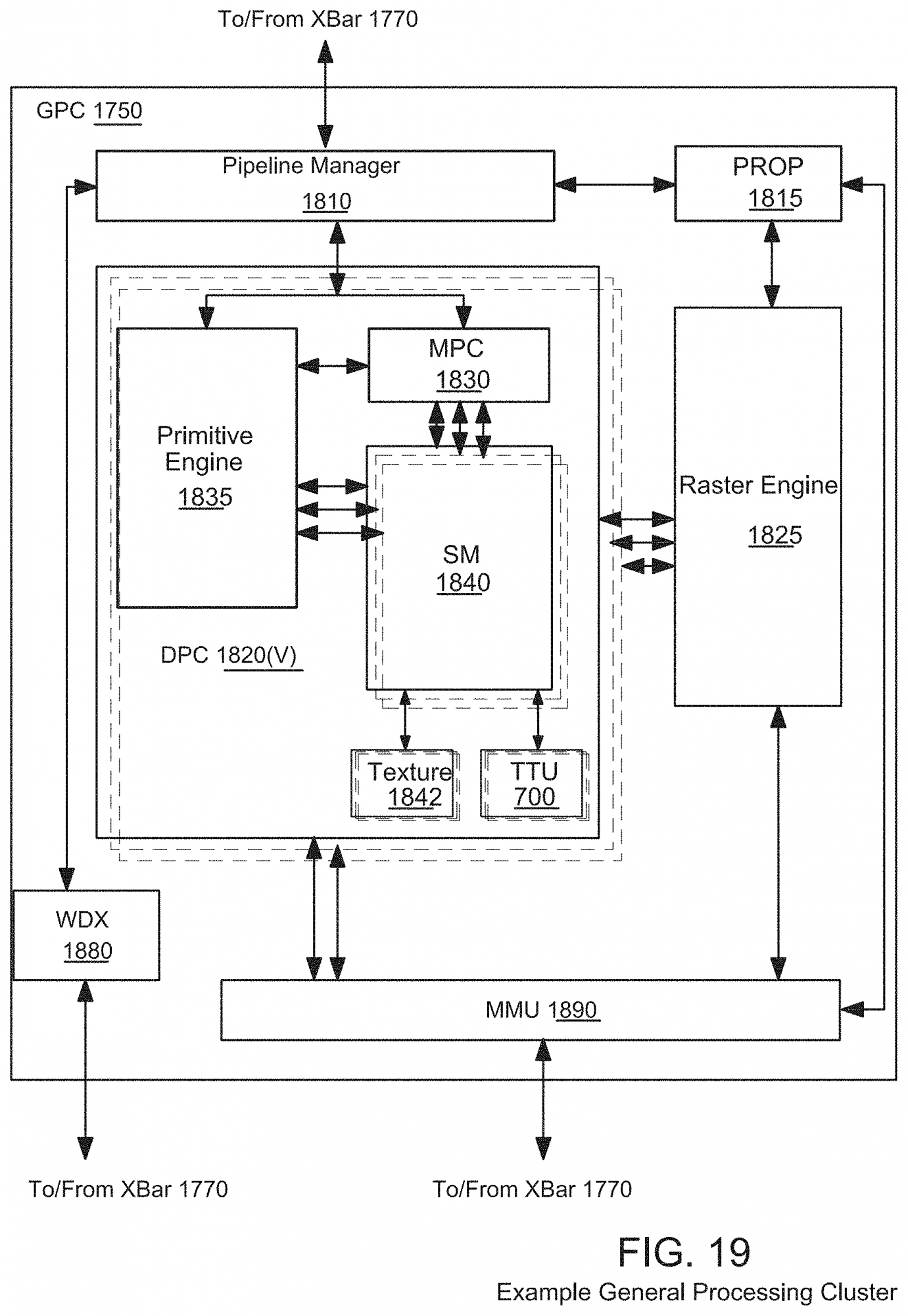

Yes memory access latency is also very important. I suspect Ampere’s L2 cache will be significantly larger than Turing.
Here’s the image from the nvidia patent describing the coprocessor interface. The TTU aka Tree Traversal Unit aka RT core is inside the TPC next to the texture units accessing the same memory subsystem (MMU).

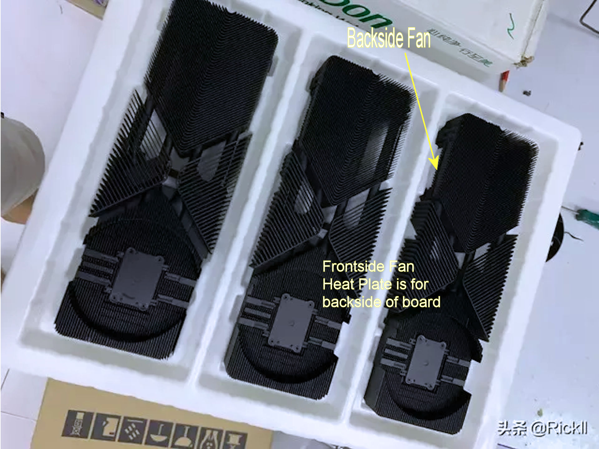

I have not seen anyone mention this, but the HiK looking plate (lowe profile, thin, vapor chamber) on the lower section would be used on the backside of the board, not the normal location for the GPU:
The position looks like it directly hooks up to the GPU on the other side of the board. That is if these are the actual design for the Ampere GPU boards/cooler. I hope Nvidia really stirs up the pot here, this would not only be for Real Time RT but could potentially transform the movie/TV industry CGI methods (Big, Big change), potentially making CPU RT rendering obsolete (maybe some hyperbola there). If Co-Processor boards can be used for RT as well (more for video/movie/TV production stuff) Wow!

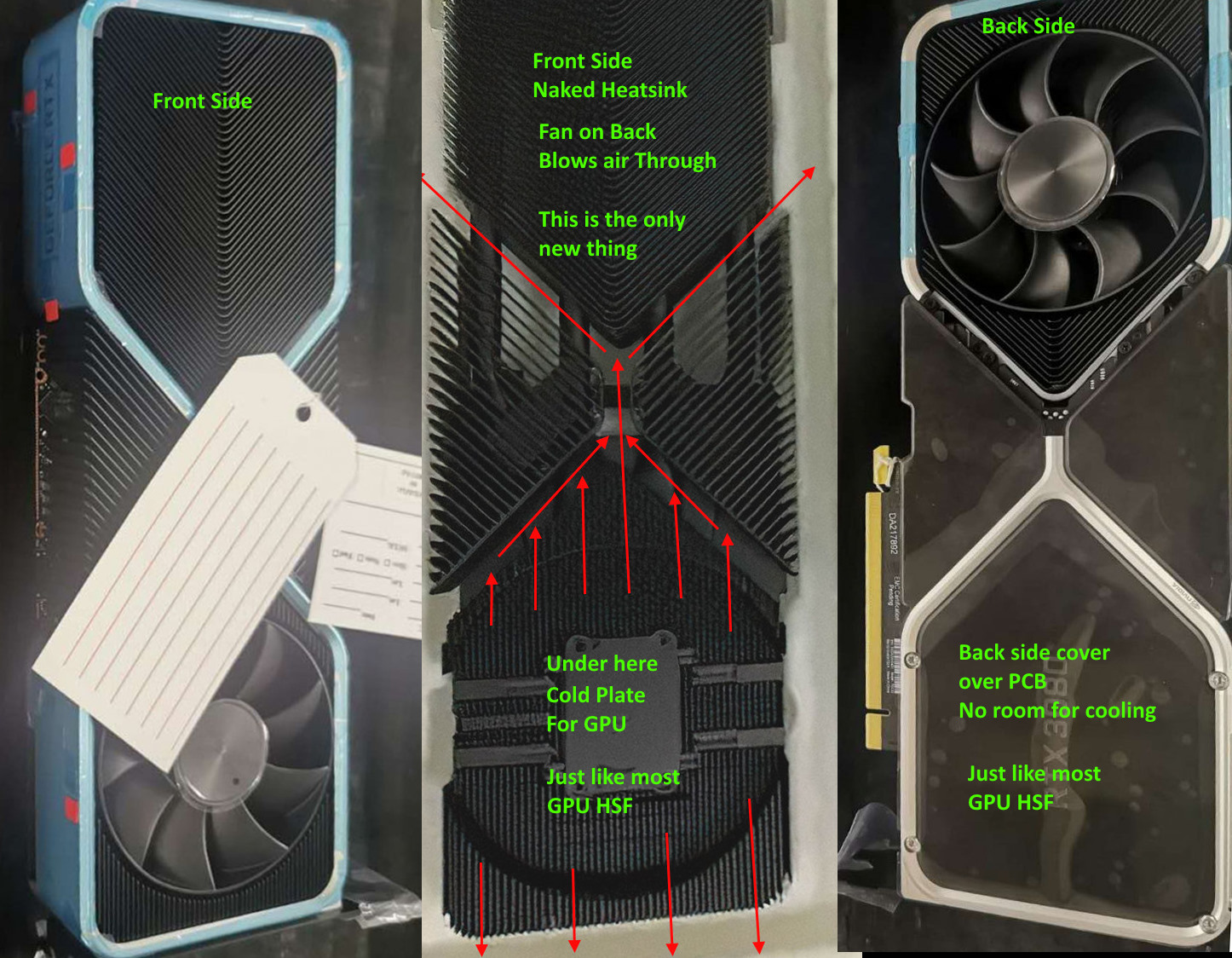

Nope. Look af the full assembled version and wireframe image:
https://hardforum.com/threads/video...tx-3080-pictured-now-thats-different.1997547/
The Fan closest to the I/O ports is in the normal front side location with the vapor chamber, and or heat pipe termination cooling the GPU chip. The second fan on the back, is after the PCB ends and flush with it. There is no way in can connect to the back of the PCB.

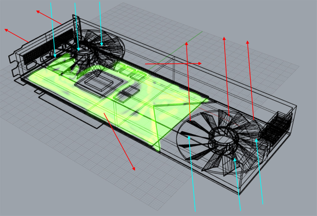

Edit: Visual aid. Green is PCB. All of the depth of the HSF is in front of the PCB, there is no depth left for cooling on the back.
Not seeing it, getting old :D. Anyways your drawing is just someone's perception of configuration of components and not official as far as I can tell. Maybe this will help, still presumming the weird cooler design is for gaming Ampere:
What I am thinking is a whole section which covers the GPU, heatpipe etc. is not shown here. Do agree with you on configuration depth on backside of board for a normal board.
Then again I think you could be 100% correct in that the bottom section with the vapor champer in the box above is the section that on assembly would be fliped around on top of the GPU and the fan fits onto the raised surface, which in that case the fins do look rather shallow for a fan. In the above image, hard to tell it looks to be one piece making that less likely.
The above is most likely a mock up and not a real heat sink configuration, could be a configuration that is not going to be used.
Your image caption is nonsensical. How does a frontside fan and heatsink cool something on the other side of the card. It's obviously there to cool the GPU on the front of the board, as it always is.
Here is the assembled unit both sides, properly oriented vs the naked HSF:

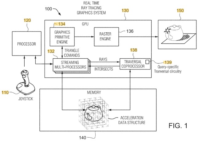

https://patents.google.com/patent/US20200050451A1
Fun part is that I suspect NVIDIA's patent filings to be the "source" for the claimed "RT Co-processor".
If you look a this picture (FIG.1):
That "Traversal Coprocessor"(138)...is the RT-Core....inside the GPU....but sprinkle that with some ignorance add some on fluffy feelings...and voila...we have a retard-rumor.
Another fun fact in reading the patents is that the NVIDIA hardware has capabilities (in regards to raytracing) that EXCEED DXR 1.1 specifications.
So RTX Turing is DXR 1.1+ compatible...I wonder how far off DXR 1.2 is? ;)
Thanks for the time and work on this, duh on my part, this sits right on top of the board and GPU. Have to agree with you not much room will be available on the backside of the board unless a backplate is sufficient cooling for a given chip.
Since a speculation thread, anyways here is a layout of a 2080 Ti board which is relatively stuffed or used:
Now Ampere is looking to be using a smaller board, if the above heat sink represents how these cards are cooled, above HS maybe just for the 3080, no idea. So will Nvidia be able to fit or shrink down the footprint for VRMs, Memory and everything else on that board and use DDR 6? Will Nvidia pull a big surprise as in using HBM, Interposer and maybe something else? Not saying one way or another.

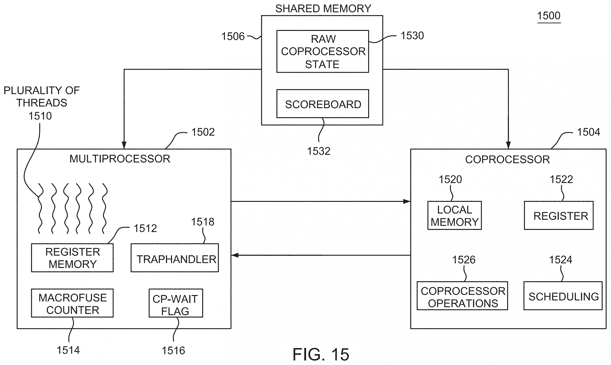

These figures are just used for explanation and not necessarily represent every configuration that the patent covers. Patents, like most good patents covers as large a scope as possible:
0160]
The hardware unit that implements/executes such an operation is herein referred to as a “coprocessor,” irrespective of the degree to which it is integrated into the multiprocessor. Many embodiments below are described in relation to TTU 700 which operates as a coprocessor of the SM 132 by, among other things, accelerating the BVH traversal process for the SMs. However, it is not required that the coprocessor is a TTU, or even that the coprocessor is independent of the multiprocessor to a similar extent as the TTU 700 is independent of the SM 132. For example, although TTU 700 is substantially independent of SM 132 in that TTU 700 can detect many types of ray-BVH intersections without further communication with SM 132 after the ray and BVH information is received, the multiprocessors and coprocessors in example embodiments are not limited to any particular level of intercommunication between the multiprocessor and the coprocessor during the execution of the coprocessor operation.
The patent then covers communication using a communication bus, added memory, own scheduling of threads. . .
General Multiprocessor-Coprocessor Interface
[0235]
As described above, embodiments are not limited to a multiprocessor-coprocessor interface that corresponds to the interface between SM 132 and TTU 700. FIG. 15 shows a system 1500 including an interface between a multiprocessor 1502 which may be different type of multiprocessor than SM 132 and a coprocessor 1504 which may be a different type of coprocessor than TTU 700. Multiprocessor 1502 and coprocessor 1504 may communicate directly over a communication bus 1505, and both may have access to a shared memory 1506. The shared memory 1506, although shown as being located outside the coprocessor 1504 and multiprocessor 1502, is not limited thereto. In some embodiments, the shared memory 1506 may be located inside the coprocessor 1502, separately or integrated with a local memory 1520 of the coprocessor. In some embodiments, shared memory 1506 may be cache memory (e.g., such as L0/L1 cache of the TTU 700) or other memory to which the coprocessor has only read access.
[0236]
Multiprocessor 1502 is configured to concurrently execute a plurality of threads 1510, and may be further configured to command the coprocessor 1504 to perform one or more of coprocessor operations 1526 to accelerate the processing of one or a group of the plurality of threads 1510. As described above, in a SIMD multiprocessor a group of threads (e.g., a warp) may be scheduled to execute concurrently.
[0237]
The coprocessor 1504 may include its own scheduling 1524 that can ensure fair scheduling for work items (i.e. threads) submitted by the multiprocessor to the coprocessor. The coprocessor may also include its local memory (e.g., RAM) 1520 and registers 1522.
In other words it does not rule out a seperate external co-processor for this. Will Ampere have a separate chip for RT -> No idea. Appears the patent does allow that configuration how ever hard that would be hooking up to each SM on Ampere (patent for the most part ties the Transversal Co-Processor to the SM, meaning multiple Co-Processors or RT cores, like in Turing).
Yes, it does rule it out. The patent and included diagrams describe an interface from an SM, including the snippet you quoted. An SM clearly can not communicate directly with an external chip. Nothing in the patent makes accommodations for off-chip communication.
If you’re familiar with nvidia patents they explicitly mention multiple chips and nvlink when applicable. There’s no mention of either in the coprocessor patent.

The patent is not limited to what type of connection between the Co-Processor and SM, image further down shows example of a SM -> NVlink may or not be used, patent would still be valid since it covers any communication means between the SM and Transversal Co-Processor meaning it could be internal to GPU or external.
[0235]
[0236]
[0237]
The patent is clear on what represents a Microprocessor in regards to this patent, which is basically a SM:
The patent covers an external Coprocessor with increase functionality potential hooked up to the SM. Using whatever communication method. This is very clear but folks can make up their own mind if even relevant or importantt to know. As if Ampere will extend RT performance by using such methods only Nvidia and a few others privy to the design know for sure. I have no idea if Ampere does or not, the patent does not exclude that sort of configuration and that would also be covered under the patent if ever used.
I would be very excited with something like this since it could handle most if not all of the BVH, decreasing memory loads and would basically be a paradign shift for RT (RealTime) raytracing.
Now I would like to know thoughts on how Nvidia will construct and place the different components, anything else new, on the shorter board.

Of course you are correct in the implimentation to all the different SMs would be, while rather interesting, I am not sure if practical or viable at this stage. Ring bus, star . . .
They never are. Patents are always as broad as the can get away with.
You just keep repeating the same empty defense of BS speculative click-bait.
No, just reponding to lack of NvLink statement means it can't be external to the GPU. The patent covers it and Nvidia may indeed extend capability as a possible means now or in the future.
I have no idea if what was presented was motivated to get more clicks or not, if you can read minds and motives -> power to you. Don't have to defend anything.
I mean, speculation is part of the thread title. If we can't speculate, not much point to the thread. Still speculation that they will choose that thermal design. I personally don't think they would put an RT processor on the back of the card. If anything it would be some type of chiplet, stacked design. Speaking of which, I certainly hope Nvidia is entertaining these chiplet style ideas, because their gpu sizes are getting out of control.
