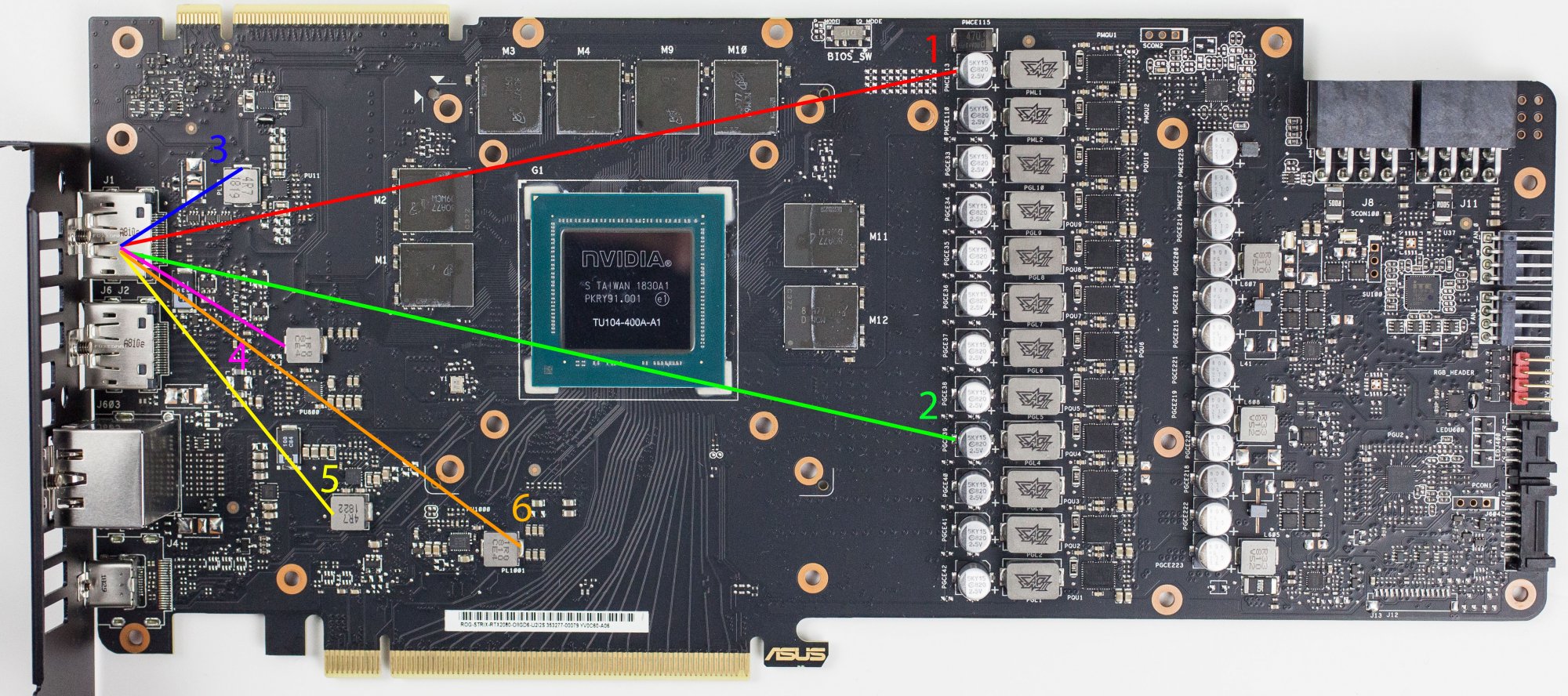

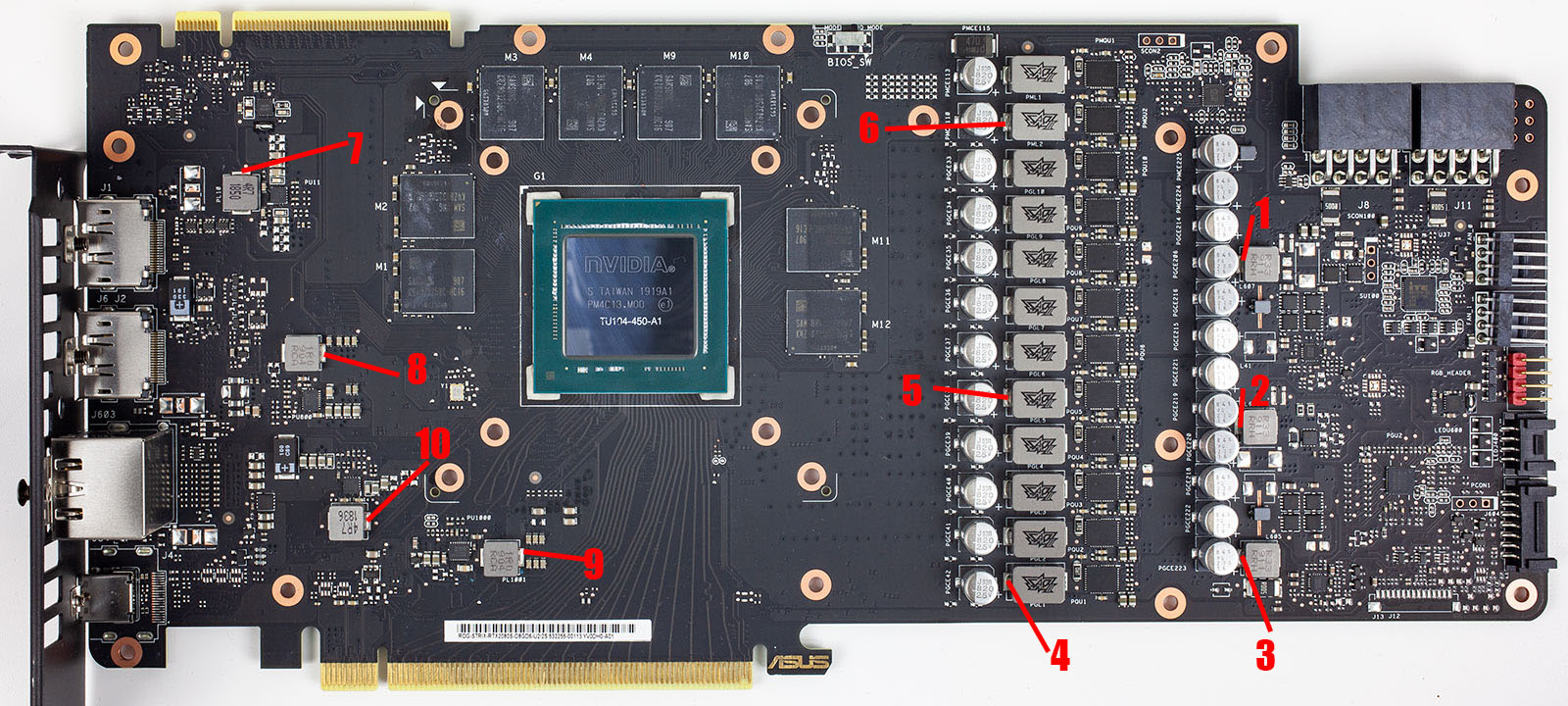

So I've got an ASUS ROG Strix 2080 that doesn't work. The LEDs on the housing come on but there are no other signs of life and I thought this GPU would make a good project to learn electronic repair - I've been trying to get into this for some time.
I could really use some help as I think I'm hitting the ceiling of what I know (very little) about electronics.
As far as I can see, there are no physical signs of component damage, and whilst the card LEDs do turn on, the fans don't spin and I'm not able to POST. The GPU does not get warm so that's somewhat reassuring.
So far I've been able to determine that none of the 12V rails are shorted to ground nor to Vcore or Vmem. There are no boardview type images/documents I can rely on for identifying rails, but an initial voltage test revealed 12V coming through to three inductors on the right side of the board (labelled) as well as the bottom left, as well as 3.3V in the bottom left. 5V were identified at the top (labelled), and one of the inductors appears to short to ground (approx. 0.2-0.4 ohms).
The part I'm not so proud of... after a long exam today I decided I would come home and jup right into diagnostics... and that's where things went a bit sideways. I tried measuring across a small capacitor (don't ask why I thought this was a good idea) and ended up touching another component (a resistor I think) at the same time. This caused the PCI-e extender ribbon to smoke (I ended up burning the first two pins (12V) on the back and front of this ribbon. I used a riser cable as my current tower isn't large enough to house the bare GPU and try to test voltages etc very well simultaneously.
There's no identifiable damage on the GPU pcb. I decided to hook the GPU up to the motherboard directly, and the PC would no longer start. Knowing I probably shouldn't, I tried to restart the computer which caused a spark across what appears to be a sense resistor adjacent to one of the Vcore phases - nothing else appears to have changed with the GPU in terms of shorts to ground (the original unidentified power rail is still shorted to ground) and there doesn't appear to be any 12V shorts to the Vcore either. I've got a new Corsair RM850 so i'm hoping it kicked in quick enough to prevent any serious damage to the board.
I haven't connected power since in case it burns the card outright, and I'm having difficulty narrowing the potential original short to the potentially culprit component (I'm hoping it's not a short within the PCB) as well as trying to figure out if I've now introduced a new problem (I suspect it is related to the 12V power supply from the PCI-e as that was what was blown on the riser cable I was using).
I can't seem to find any datasheet about the powerstations/MOSFETs to know where I should be testing and my current attempt at trying to hot air the one off the board closest to the sense resistor that blew hasn't been successful (I will try again tomorrow).
I feel like there's more testing to be done before I completely throw in the towel, and with any luck my little mishap hasn't caused any irreversible damage. Any ideas where to go from here?

The shunt at the bottom of the card that your picture says is "smoked" is most likely wired up to the 12V input from the slot. You will need to figure out where the short is in that circuit. It's hard to say without the card in my hands to test, but if it was shorted for long enough to visibly damage a PCI-E riser, chances are that the damage is actually in the 12V power plane itself, which means the card is beyond saving. Nevertheless, it would be worth removing the suspect shunt and checking to see if that clears the short. If it does, then there's a chance the damage is a component situated between the shunt and ground, such as a power stage or a capacitor.
Also, do not use short detection ("beep") mode when troubleshooting. There are circuits on this card (such as the core and main memory power) that measure as only a few milliohms to ground by design. The core should measure about 300 mohms, as I recall, and the memory should be maybe 10-15 ohms. Both of these are well below the threshold that most multimeters consider to be a short. The proper way to check for short circuits on a graphics card is to use regular ohms mode, and compare your readings to the known-good values.
The thing I would do next is remove that shunt, and see if that clears the short on pin 2 of the PCI-E connector. Do you have access to hot air? Do not attempt to use a soldering iron.

Here's what I suspect each one is:
1. Memory Power - expected resistance is something like 15-30 ohms
2. GPU Core Power - expected resistance is ~300 milliohms
3. 5V? - I'd guess about 2K ohms expected
4. ~1V? - I'd guess about 3500 ohms
5. 5V for usb-c? - Resistance should probably be a few K
6. 3.3V? - You usually see 200-400 ohms on this
Each one of those locations is the output of a power supply circuit. By checking the resistance on each one, we're checking to see if a short circuit has formed either through the load or some part of the power supply. If either of those things had happened, that would explain why our card doesn't work. I may be wrong about which one of the ones with question marks is which, which is part of the reason we're doing these checks. We need to at least kind of know what each one does before we do the next step.

The shunt measured around 0.4 ohms, and it's now back on the board.
1 - 1.0 ohm
2 - 0.9 ohms
3 - 14.8 kOhms
4 - 3.12 kOhms
5 - 81.8 kOhms
6 - 10.2 ohms
Edit: before my probing incident, the ohms from Vmem to ground were in the 20's, so the 1 ohm appears to be new.
EDIT #2: ignore the above comment as I cannot confirm since I didn't write it down.
Also point 3 had measured at 5V before.

#1 is your problem. 1.0 ohms is basically a dead short to ground on that rail. I went and looked at some footage I took when I repaired an EVGA reference 2080 (which I'm using to type this post :cool: ), and I got 55 ohms on the memory rail on that card.
Your next step is to figure out what component is in short, and replace it. Unfortunately, this is likely to be pretty tough, unless you have some elaborate equipment. Probably 40% of the components on the board are related to the memory rail, and your short could be in almost any of them, including the memory ICs or the GPU die itself.
There are a few ways of going about this:
* You may get lucky, and figure out which components are damaged with a closer visual inspection. You mentioned you're a doctor - if you have access to a stereo microscope at work, you might try using it to examine the board.
* Plug the card into power and use a thermal camera, isopropanol, or your fingers to look for components that get hot.
* Attach a bench power supply to the memory rail, and inject voltage (it's designed for 1.35 volts), and look for components that get hot
* Speculatively remove components until you find the short.
If you strike out with the visual inspection and voltage injection, it might be worth at least removing the memory rail power stages. Just be aware that if you can clear the short by removing them, you'll likely need a board preheater and a great deal of luck to get new ones soldered on properly.

Okay so here's what I have for the inductors you labelled in the above pic.
1 - 12.05 V
2 - 12.05 V
3 - 12.04 V
4 - 0 V
5 - 0 V
6 - 0 V
7 - 4.998 V
8 - 0.025 V
9 - 0 V
10 - 0.019 V
I've struggled to find datasheets for two of the controllers, BFRJ (next to inductor labelled 7 on the pic) and BFDJ (next to inductor 10).
I've been able to deduce that:
i. BFRJ is MP28168GQ
ii. BFDJ is MP8858GQ
- again no actual datasheets have been found.

Something that occurs to me is that you don't seem to have a 3.3V rail. There's what appears to be a 0 ohm resistor on the back of the card near the PCI-E connector - see what that's connected to, and what the voltage on each side of it is.
The controller ICs, like those MP8633As, often run on 3.3V, so if the 3.3V rail is dead for some reason, that would explain why nothing works.

In the 5th picture, are the terminals marked in yellow all connected together, and the ones marked in red are also connected together?

So, the pink lines represent traces that are connecting those terminals, (and you can confirm they're actually connected with a meter), but you have 0V on them with the system powered on?
So voltage wasn't initially checked at pink lines, but showed continuity with system off and GPU on my desk.
I've checked and updated the voltages - some pink lines actually carried 3.3 V and I've changed them to yellow.
Also, the component on the back of the board that received 3.3v from the 0 ohm resistor...the leg connected to this resistor actually connects to a small resistor that carries 3.3V on one end and 0v on the other before the trace disappears into a via. Not sure where this via comes out just yet. Not sure if that changes anything in terms of tracing the 3.3v.

Check each of the controller ICs for its expected Vcc and EN. I'm guessing that what you'll find is most of them have Vcc (probably 3.3V), but En will be missing, like you're seeing with that MP2888A.
You may find that on one of them, you have EN and Vcc, but it's not running. If that's the case, troubleshoot that circuit. If you don't find any that are getting En, then you'll need to figure out where the En signal comes from for each one, and see if any of that circuitry is broken.
