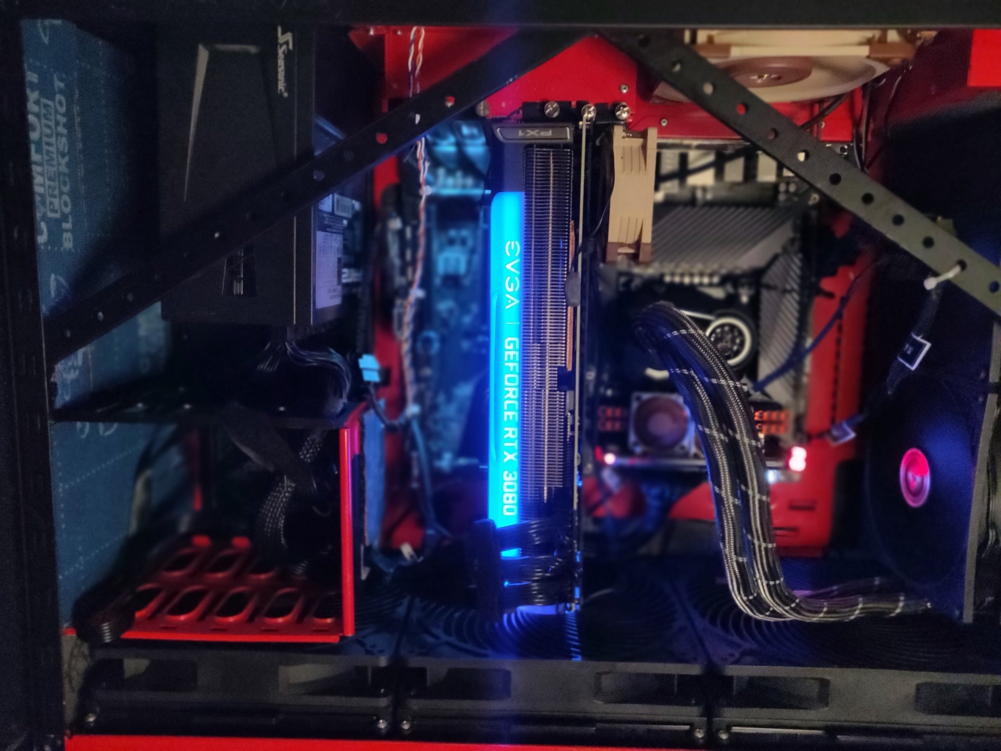

I have a pic, but I also have some bad news fellow FT02 friends.
The Strix 3080 card does not support being rotated 90 degrees. It was pegged at 90-99% fan and 79-82c when in normal orientation. I flipped the entire case over and ended up with 60-70% fan and 63-65c temperatures.

If you're not using those other pci slots, you could get a riser and vertical gpu bracket. They also make some which fit on a 120 mm fan, but looks like that would interfere with your cpu cooler or PSU. There are some which can be configured to sit over the PCI slots (so it wouldn't interfere, but you'd have to remove the bracket to add/remove cards), but they look a bit flimsy.
I think I would have to heavily modify the case to make something like that work unfortunately.

But what 3080 does work more or less as intended in 90 degree oriented cases such as this one? And it is shorter than 304mm. MSI ventus is 305mm long so idk if it would fit. I have MSI 980ti gaming atm which was doing fine temp wise (mid 70's while overclocked) until one of the fans broke and other one is on its way out so i'm in a market for upgrade.
Here comes the crazy/desperate question, how would FT02 behave if i used a card which works optimally in horizontal orientation and rotated the case as in Potatochips's picture ? Any comments and advice would be appriciated, thanks!

Gravity and certain types of heatpipes in specific orientations. Not all 3080s are like this and the info is mentioned on Silverstone's FT02 page under the Q&A.

I'm not really an expert on this, but it would seem unless you're certain that a card/cooler has anti-gravity wicking in the pipes, the bending must not face upward/be above the heat source. You can see this in the CPU cooler 'bad orientation' and again in the photo of the VGA cooler below in Silverstone's examples on the FT02 FAQ.
Many cards use heat pipes. Moreover, the 3090/3080 Strix have almost all of the bends above the heat source as seen in the photo I linked to above. The Tuf 3080/3090 may or may not be a problem as well, as three of it's pipes do the the same thing. Most of the other cards I've seen seem to be okay, but it would be best to look at their coolers. For example, 3080/3090 FE and Gigabyte Master/Extreme look fine. For the 6800/6900 cards, perhaps they have vapor chamber cooling (I haven't seen the exploded view) and things are a bit different. From what you're saying it sounds like they should be fine, but I'll wait to conclude until after TPU or some other review website disassembles them.
As a comparison, my 2070 S Strix has two pipes that bend above and the rest are below the heat source, but for all I know my card could have wicking pipes. All I know is that the card I own is fine in this orientation inside an FT05 because it stays cool and never exceeds 60-65c while gaming. Link to this cards heatpipes - https://www.techpowerup.com/review/asus-geforce-rtx-2070-super-strix-oc/images/cooler2.jpg

Stage 1: remove filter piece and slap in on from the outside with magnetic strips / if i recall that makes about 4-5 mm, yes?
Stage 2: remove the whole bracket and mount the fan directly onto the metall / uh i don't have the measurement
Btw an arctic freezer II 280 AIO does fit perfectly in there, if you are apt with a dremel.
And here the most silent FT02 of them all:
just for flex it is already prepped for a 280/360 GPU AIO
To all RGB padawans:
come to the dark side !
pump and coil whine are not an issue here :smuggrin:
