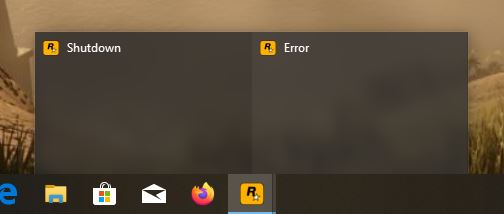

Just started a new game, finally... was watching the intro and at the part where Arthur and Dutch leave to find food, and then...
No warning, no error message, just back to the desktop you go. Clicking on the R* icon in the task bar gives me these tweo messages, shutdown and error, but clicking them does nothing... Awesome.
Are there any events in the event viewer?

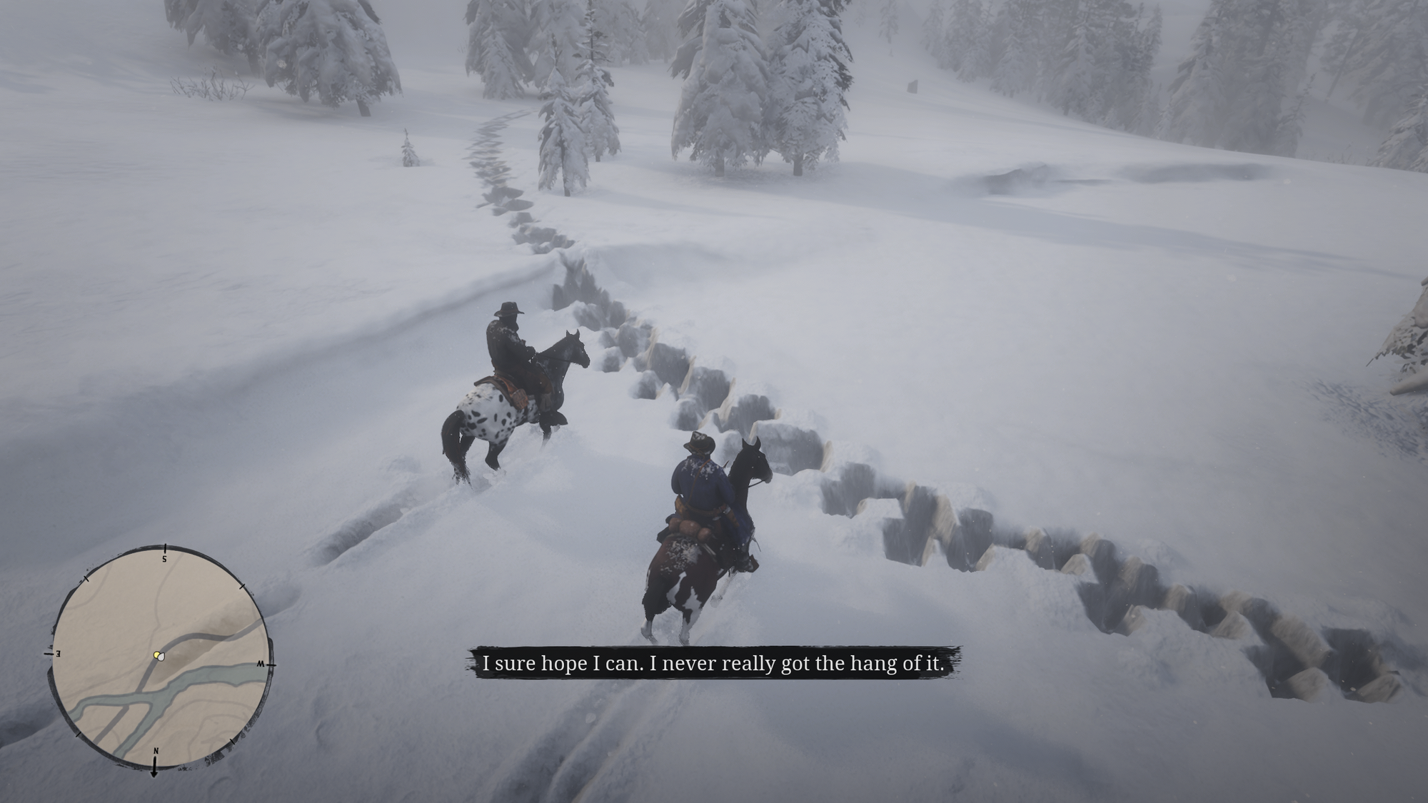

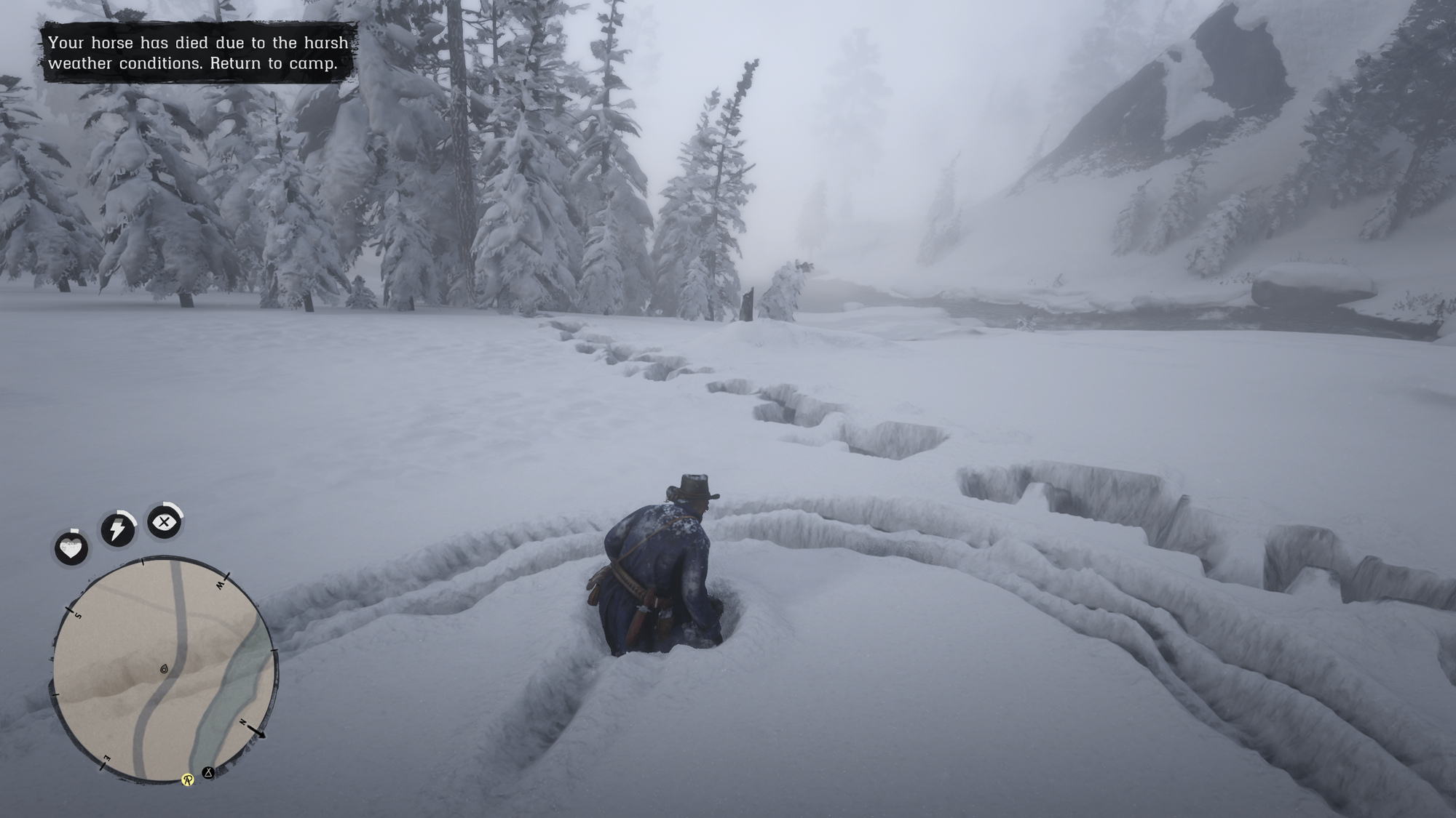

Didnt' check yet, I did change it from DX12 to Vulkan and it no longer crashes o_O, but I'm getting extremely weird snow glitches even on High/Ultra. I have the tessellation on ultra, geometry etc... When I walk through the snow, it makes the tracks as you'd expect, but the existing snow tracks look like shaded squares, and as I approach them, they slowly sink down, however they still remain squares. Hard to explain, but when you look at snow tracks I make, you see a proper tessellated pattern. But on existing tracks, the square patterns slowly sink down as approached, keeping a square pattern. This on a 5700 XT, latest drivers etc...
View attachment 199488 View attachment 199489
Does it do this on every tessellation setting? If you changed the tessellation setting in the Catalyst Control Center you may want to change it back to application controlled. If you haven't, then try playing around with it and see if anything fixes it.
Yeah, happening on every tess setting. I haven't changed any of the Catalyst settings, besides turning on the Image Sharpening. Apparently a number of user's with 5700 XT cards are experiencing the same issue, found it posted on reddit and the AMD community. Interesting too is that a Dev replied that R* is investigating the issue, but that NV card's have been affected by the same bug, though I've yet to find any reports of NV card user's, just ppl with 5700 XT. Also, it's not just the snow, it's affecting all tessellation area's, so Mud, Snow, Swamp etc...
