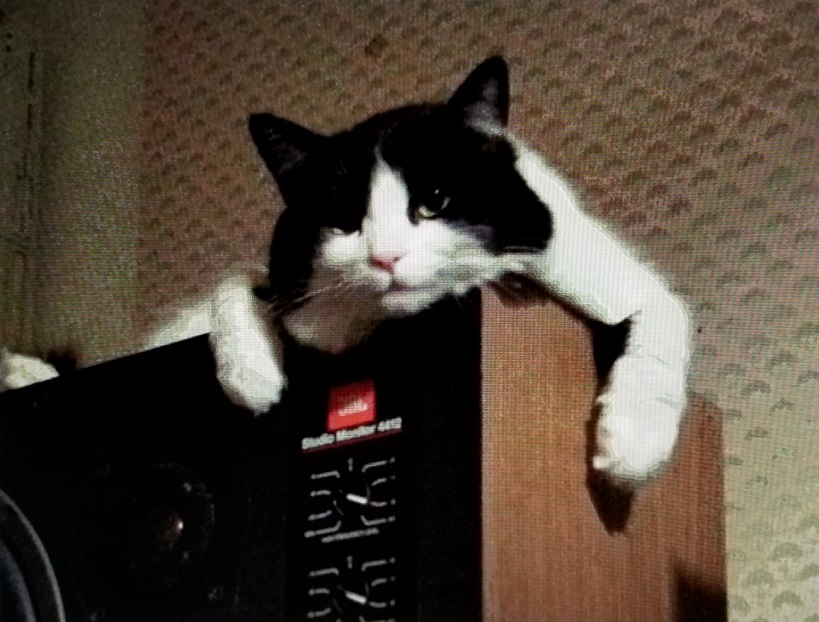

Can you take a photo of the effect?
Below is a picture I took of my monitor while the problem was occurring. The banding is particularly easy to notice on the paws.
Original image for comparison:
I can confirm now that "Ctrl + Windows + Shift + B" does fix the issue when it occurs. That's much more convenient, thank you. I'm still very curious about why it's happening in the first place.

In the process of trying to research the issue I'm having I have come across quite a few posts that seem to talk about the issue you had (example). I'm not convinced that issue is related to the issue that I'm having.
A common theme with that issue is that it occurs when the monitor is cold and goes away after the monitor warms up. I don't recall ever having my issue when the monitor is first turned on. It happens randomly while I'm using it. It doesn't go away on it's own. The color banding simply remains the same until the display driver is reset. There are no horizontal lines or noticeable corruption on the screen other than the color banding. It also never happens during gaming. It usually happens while browsing the web. It hasn't been getting any better or worse over time, and only happens maybe once or twice per week on average (that's why it took me a bit to update the thread with pics). Maybe my monitor will develop that issue at some point but i'm pretty sure that's not what's going on with it now.
Yeah it doesnt sound exactly like my problem, but it might be a related issue with the monitor. The fact that it is only this monitor and not your other ones does kinda point to it being the issue. Might be a backlight issue also as your banded picture looks a lot darker than the original one.
