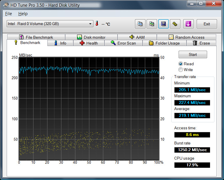

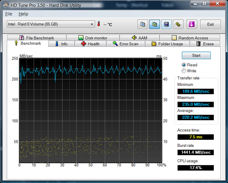

Yes 25% of a 640 drive is about the best size for data transfers. Any smaller you can get better access times. As seen by my images above.
