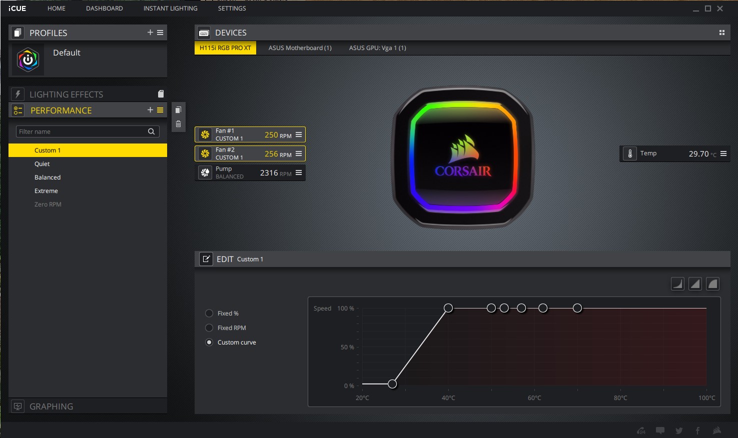

I think I'm missing something here... These are the settings that I'm using now... but it doesn't change the fact that the temp that they are showing on the right, are *still* coolant temps, not cpu temps... and that 29.70C that they are showing, is *well* below the 45C that the other programs are showing for the cpu !!
click the 3 line menu thing next to it. you are missing the drop-down menu above the curve window... ice up to date?
edit: but that is basically my setup, just my low fan speed is at like 20%.
*am* I using an old version? I have 3.37.140...
When I click on the three-line icon next to any of those four objects, I get two options: 'Unpin from dash' and 'Pin to space'. Selecting either of those, does not do anything visible on my machine!!!

NO!! I got it!! The Sensor label above the graph, is a pull-down menu... one of the options is 'AMD Ryzen 7 3700X Package' ... Once I select that, it is looking at the cpu temps, supposedly...
Okay, let me experiment with this for awhile... sadly, the 'temp' field is still showing coolant temp, not cpu temp... but as soon as I selected AMD package, it fired up the fans until the cpu was down below 40C (currently at 35C)...
Okay, I (think I) know what is going on now...
Thank you, pendragon1 !!!

look for "check for updates" in the top menu somewhere.
oh ok.
dont we all sometimes....
edit: do you have the usb cable hooked up? nm silly q if you see the pump temp. maybe reinstall. there should be that dropdown....
edit2: motherboard control suites, like the asus one, can take over and cause the dropdown to not show as it doesnt detect the cpu sensor with them running. got one running? or other monitoring software?
