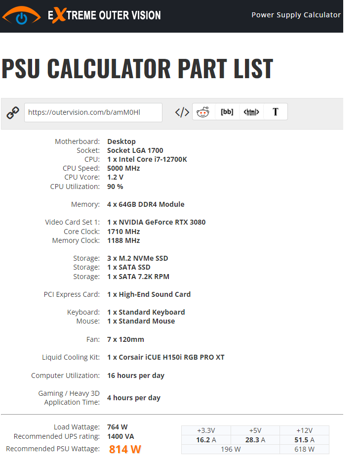

I'm building a new PC with i7-12700k and my EVGA 3080. According to several PSU calculators, my new system will require 810w - 820w. Would an 850w PSU like the Seasonic SSR-850TR be sufficient or should I spend the extra $70-ish and grab the 1000w version? My 750w Seasonic has been a smooth operator for the 3+ years it's powered my current build.

Here's my build and the wattage calculated. I had to improvise on the RAM because the choices don't include DDR5. I plan on running with 32GB DDR5, not 256GB DDR4. I figured it best to overestimate. I don't have a sound card, but will have a 7-port USB 3.0 card.
Putting that ram adds almost 100 watts to the recommended PSU.
The calc shows 639 load wattage and 689 recommended PSU for my setup. I have utilization set to 24/7 since I don't turn it off.
Not sure why Setting the Computer Utilization from 1 to 24 hours would change the Load Wattage. The Load doesn't get higher with the PC just being on longer.
As I wrote, tha calculator doesn't offer DDR5 so I intentionally overestimated with my RAM choice. I have no idea what wattage is needed for 32GB DDR5. If I find a calculator with it as an option, I'll update my results.
