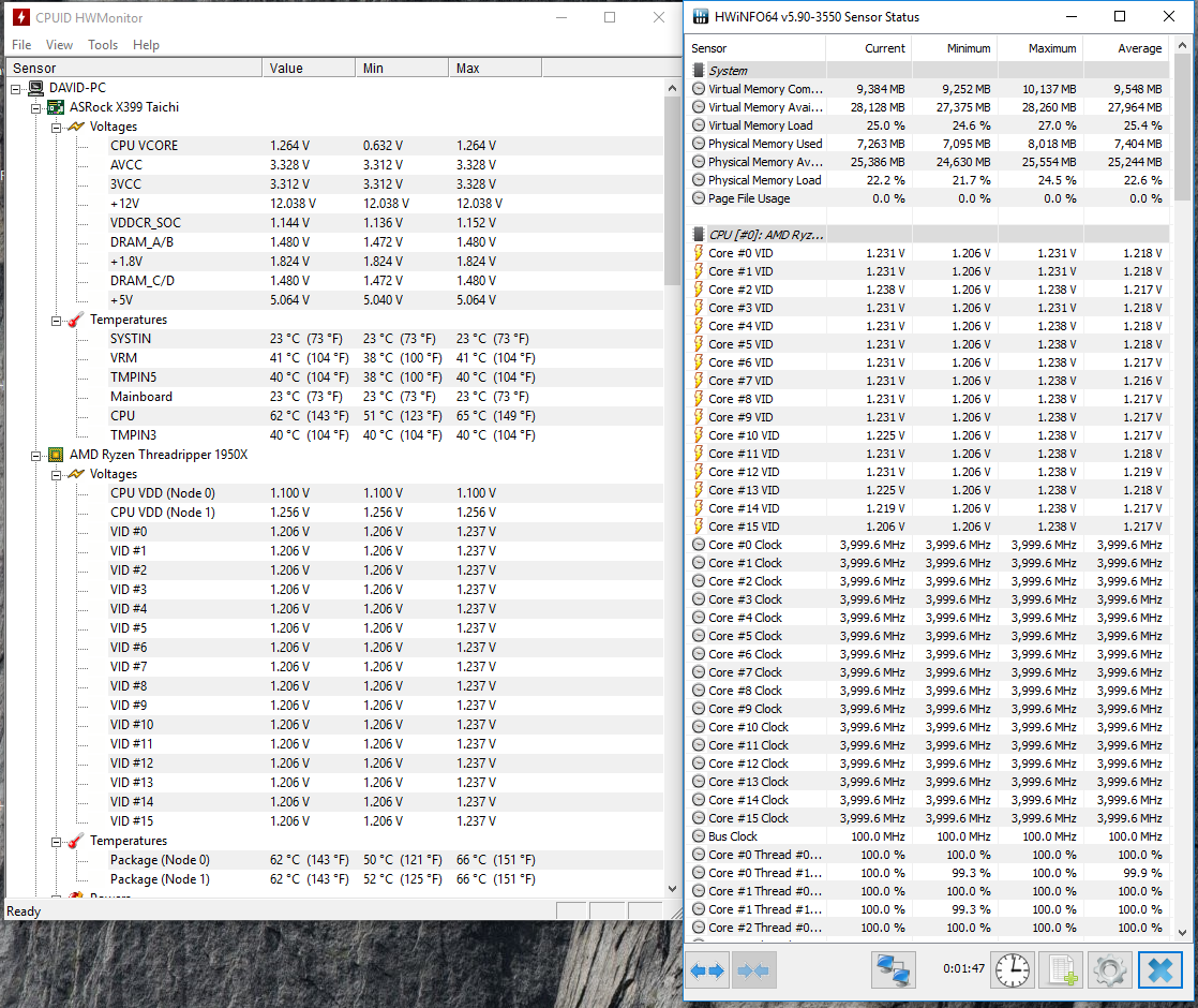

What is CPUz reporting your vCore at under load? And is there a vCore listing in HWInfo? See if those match up. And congrats for getting it back to where you want it.I think I found stability. The only thing new I changed was CPU LLC from 2 to 1. Ran 3 instances of Handbrake simultaneously with very high quality encoding settings, taxing the processor to 100% for 3 1/2 hours. My system did not freeze up and the max. CPU frequency hit 4.5Ghz. Does this mean that I can consider it stable? As I mentioned before, normally when I encode video, I only use a single instance of Handbrake which results in all threads fluctuating percentages but all threads do not sit at 100%. I would assume there would not be any encode errors with only one Handbrake running?
Not sure what I should be looking for with voltages. In HWMonitor, the CPU VID for all 16 cores were constantly fluctuating with min. values. I'm not sure what VID is. What are your thoughts based on the screenshot picture below?

With ambient temp. of 62F in the room, the max. CPU temp. hit 68C. With the ambient temp in the room more realistic and more comfortable (70F), the CPU temp will max 71-72C. CPU throttling happens with temps. above 68C which is counter intuitive because stock settings will encode video faster than a throttled overclocked CPU.looks really good, what are your load temps looking like?
That is all good and a badass overclock on a 1950X at that vCore. You done good!I've got my system running under load now at 100% across all threads. In HWMonitor, where should I be looking for vCore value? At the top of HWMonitor, CPU VCORE is the same for current and max=1.264 V. These values haven't changed in 20 minutes of being under load so far. CPU-Z Core Voltage is also reading 1.264. Is it normal for these values not to change or am I not paying attention to the right numbers? See below.
