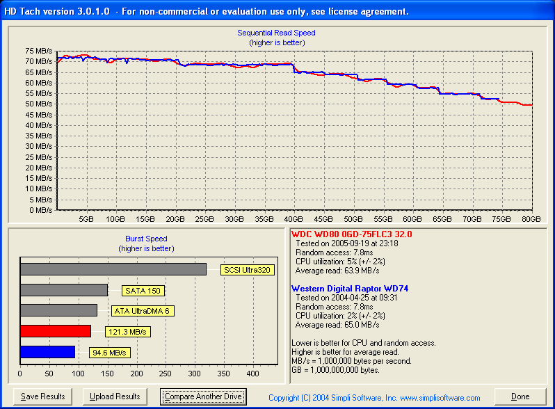

so, should I get one of these and bench it againt my regular Raptor?
That would be awesome, if you can. A simple run of HDTach should explain which theory is correct: Joe's that it is simply using all of two 40GB platters and the 74GB versions are short stroked to improve performance in the inner zones, or my original theory that the drive has new platters and it has been rezoned.
If Joe is correct, the transfer graphs of both drives will overlap, and the WD800 will simply have another 6GB at the end, and likely another step down or two in transfer rates. If the drive has different platters, there will be small but noticable differences in the transfer rates of each drive all the way through.
With the anecdotal evidence so far of the WD740GD having significantly higher inner zone trnasfer rates than 10K SCSI drives of the same generation, methinks that Joe's theory is closer to the truth. We could all be wrong though.
Here are my results, overlaid with the HDTach provided values for the standard Raptor.
StorageJoe said:
Not nescesarily, it may be the other way around. The reason they went with 36 gb and 74 gb capicity size was to integrate into existing enterprise capacity sizes. The could have just short stroked a 40 gb platter to make a 36 gb platter size. If this is the case, transfer rates on the outer most tracks should be the same and on the inner most tracks on the WD800GD it should actually be slower than on the inner most track on the WD740GD.
good job!
It means what StorageJoe said, that the WD800GD and WD740GD are using the same platters and geometry. They perform identically through the first 70GB, WD800GD simply has another 6GB zone at the inside of the disk at a slightly lower transfer rate to yield a full 80GB of capacity.
For the original intended enterprise market of the Raptor, capacity is not important as performance, so WD simply disables the last 3GB of each platter, as 73GB matches competing SCSI units, and it makes the drive looks much better with an abnormally high ending sustained transfer rate that will show up in reviews.
The drives should perform identically, except for the 6GB at the end (less than 10% of the WD800GD's space)
