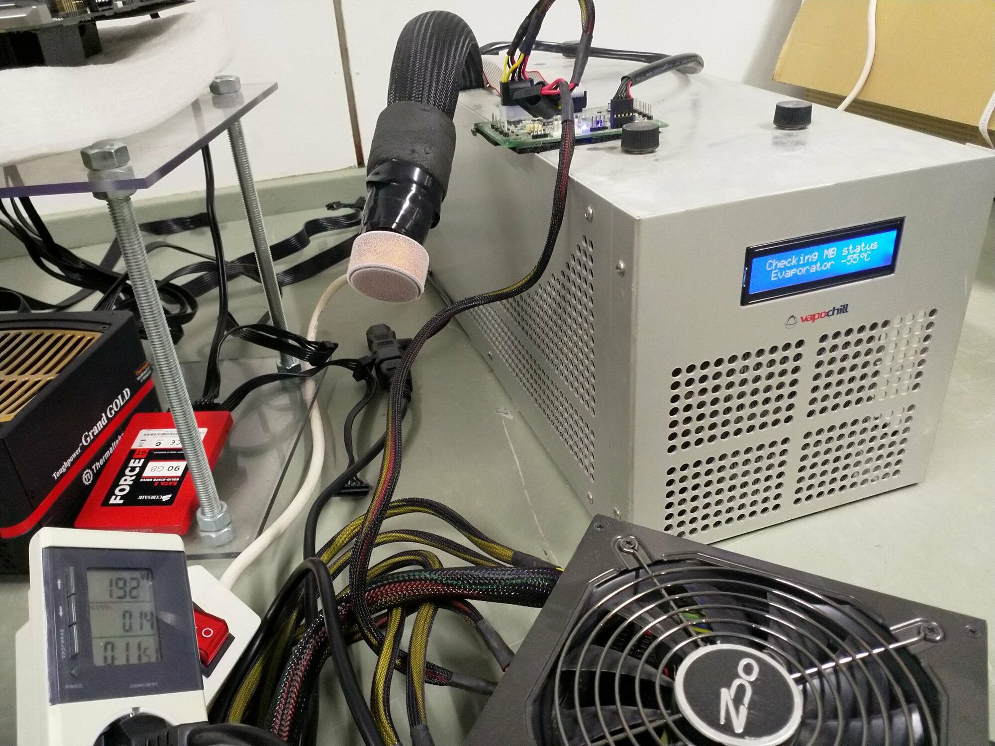

    Or you can get a phase change cooler, if you can find one, like the Vapochill

    Vapochill causes condensate on the motherboard. The only way to do this (in my opinion) is to get a cooler with at least 3x the capacity of the Vapochill and cool the whole case - that way, the condensate is kept away from the electronics
