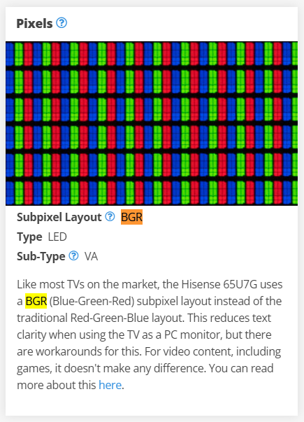

However, there's a fix for your TV. People can fix ClearType on any BGR panel of any technology (including HiSense) via downloading Better Cleartype Tuner and switching ClearType to BGR instead of RGB.
The software is great for all televisions including odd OLED and LCD pixel layouts, to make text look better.
Then the HiSense television text became sharper, and looked closer to a computer monitor, much better text more comfortable at close viewing distances (like using a television as a desktop computer monitor, which I also do too sometimes). This is because many HiSense LCDs use BGR pixel layout, and ClearType has a BGR mode.
RTINGS HiSense U7G television at www.rtings.com/tv/reviews/hisense/u7g
