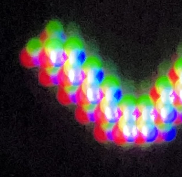

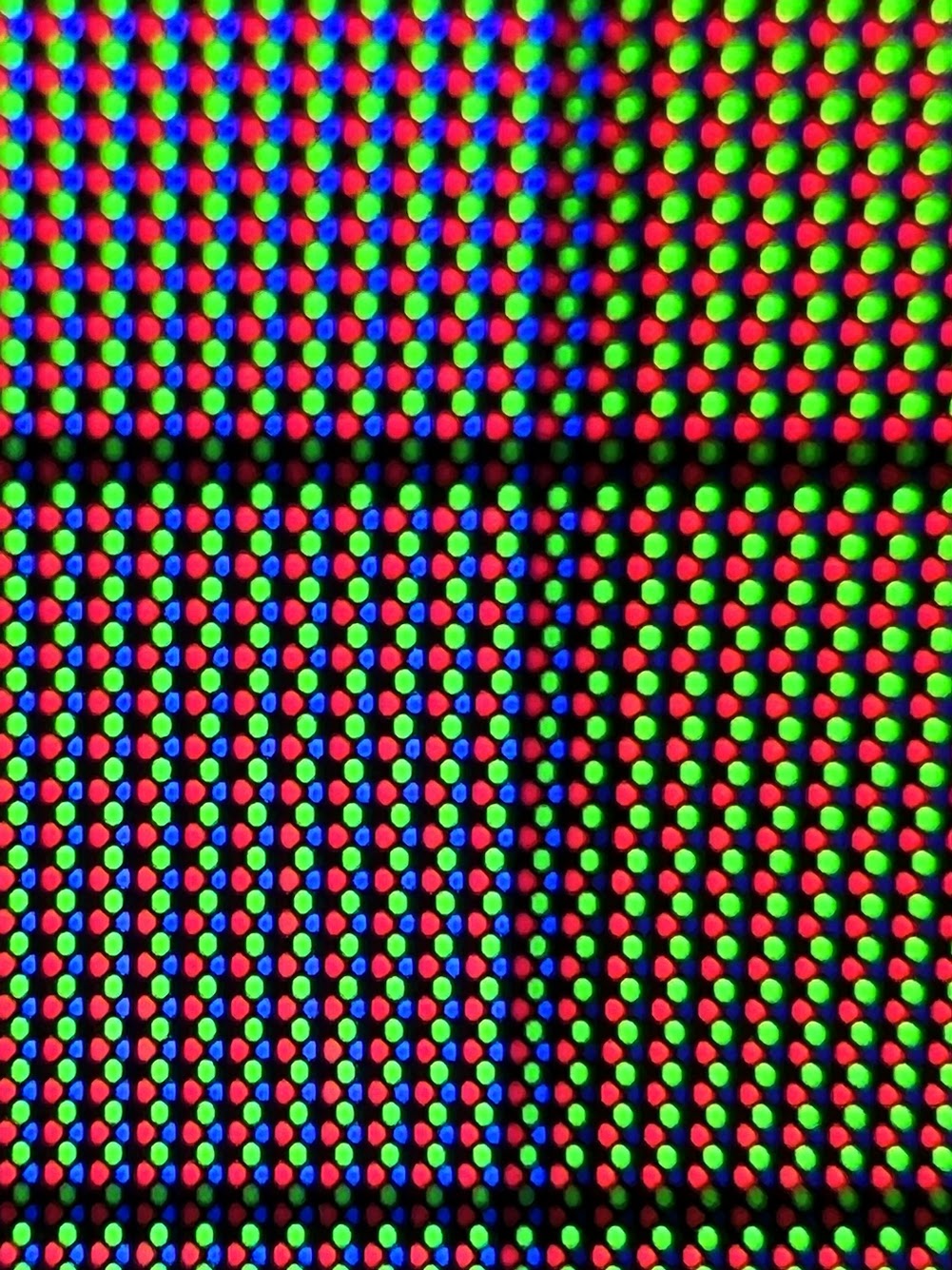

Hard to get a picture with all the phone camera BS that filters light and such:
Looks like a bunch of pixels but zooming out looks rather normal lol

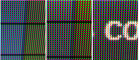

Lifelite: What are you showing us? Some of the photos look like vertical edges between white and yellow. I agree there are no artifacts there on the AW3423DW (as Zephyr showed in his photo). Your photo with the text looks like white on a dark background. What does it look like with white on a *black* background?

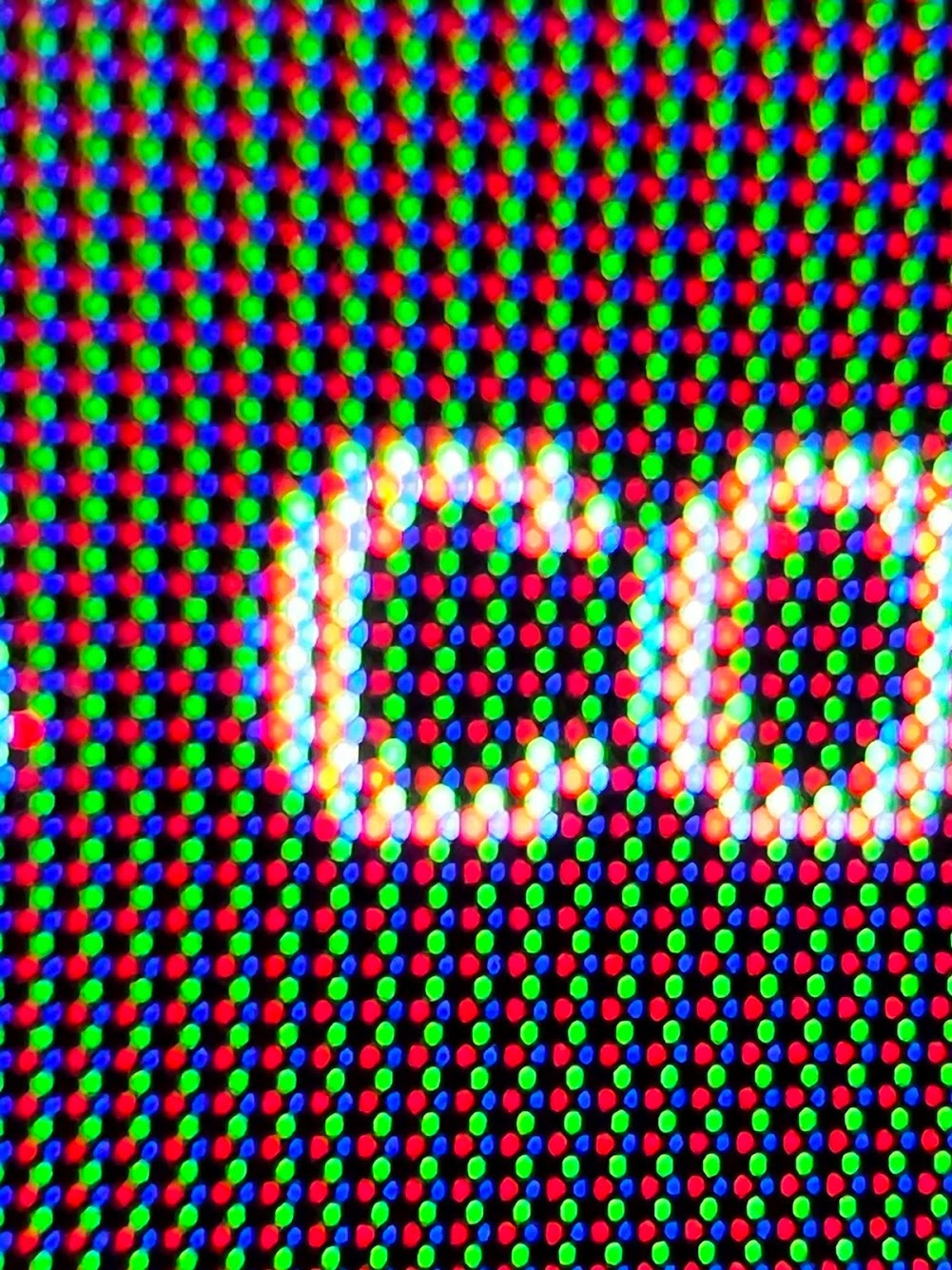

Oh sorry never described. The text was a forum post here, text with black background. For white and black, I just cannot get my camera to properly focus because of the insane contrast lol

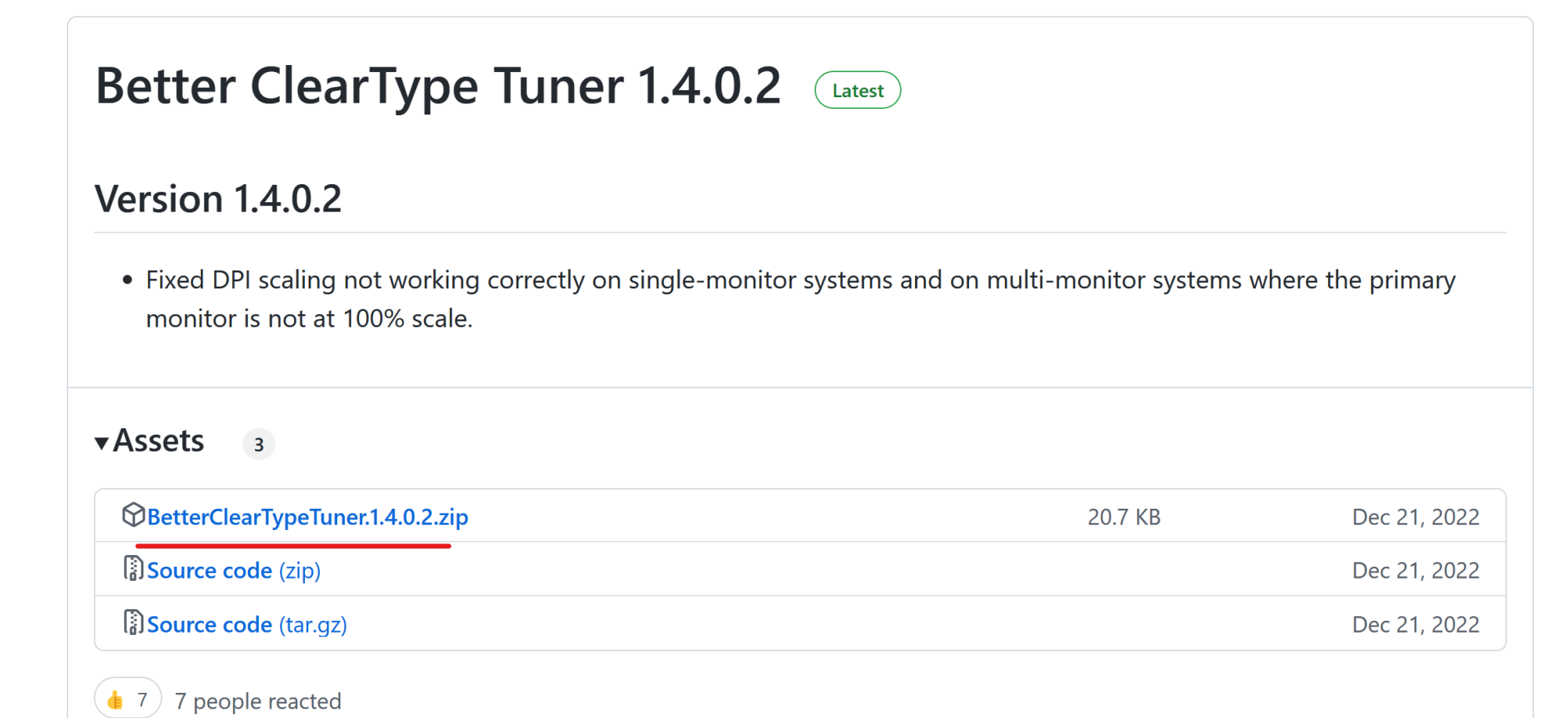

Anyway, to get back to OLED color fringing topic, Better ClearType Tuner can help reduce fringing with computer text quite a bit on any OLED panel ever released. So definitely download it for your OLED to improve your text. However, this does not affect color fringing on things like yellow objects on black or white backgrounds. (Continued photography is welcome on all models and brands of OLED, I'd love to see more.)
I fixed ClearType on a HiSense TV via downloading Better Cleartype Tuner and switching ClearType to BGR instead of RGB.
Then it looked perfectly like a computer monitor.
This is because many HiSense LCDs use BGR pixel layout, and ClearType has a BGR mode.]

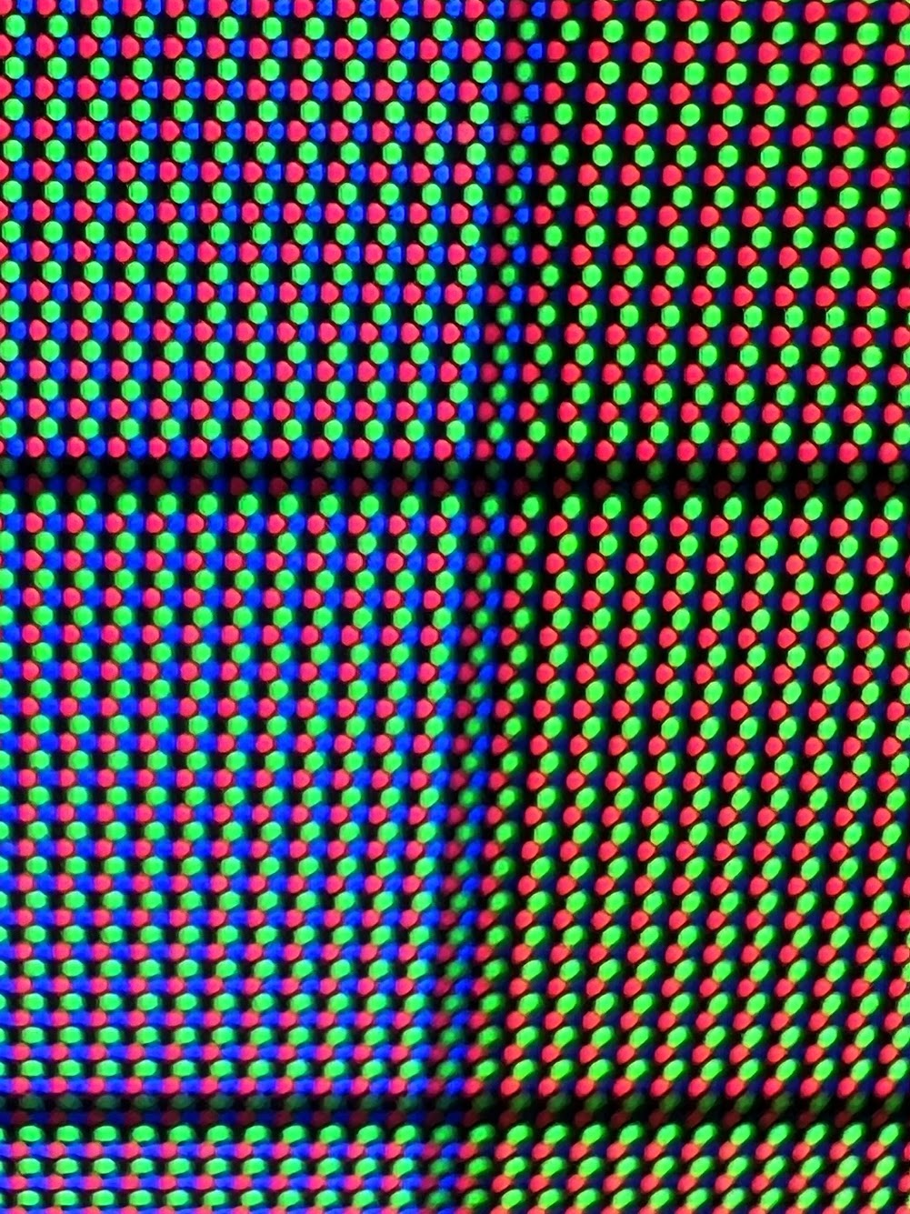

Even in this blurry photo, you can see the publicly known Samsung QD-OLED horizontal fringing artifact. So it's not just LG.
  • GREEN fringe at top of WHITE objects on dark backgrounds.
  • MAGENTA fringe at bottom of WHITE objects on dark backgrounds.
Just that you have to test different color pairs when testing on LG, versus testing on Samsung. And fringing direction is different, since Samsung is horizontal fringing and LG is vertical fringing. There are other color pairs that have fringing too, but these cherrypicked color pairs (LG white/yellow and Samsung black/white) is just among the more noticeable, especially for pixel-sharp edges more common with computer use than with video.
This is less visible at television viewing distances (and television content), but more visible at desktop viewing distances (and computer content). So make sure you test apples-vs-apples angular pixel densities. Also the addition factor that human vision varies a lot, some of us blatantly see the color fringing and are annoyed by it, while others just don't care at all. RTINGS and other reviewers talk about OLED fringing already, so this is all public information already, which I'm just parrotting here from my POV.
Camera Tip Addendum for Samsung Black-and-White: Follow the camera instructions in my earlier post, but focus on a bright part of the screen. THEN tap-n-hold to lock the focus (works on Android and iPhone), and THEN move the camera to the dark part of your screen. The pixels will stay sharp and avoid becoming overexposed.

@Chief Blur Buster: At first I thought you were being pedantic and the names WBGR and RWBG were equivalent. Now that I think about it the distinction is important and you are correct. There is no algorithm mapping pixels to subpixels that attempts to prioritize vertical alignment. They are simply lighting up the appropriate subpixels in each RWBG group. The reason yellow is such a problem is because it is comprised of red and green and those subpixels are so far apart that they don't blend into one color. My 1-pixel vertical line uses R__G and my 2-pixel vertical line uses R__GR__G. The yellow "pixel" in the center is actually comprised of subpixels from two neighboring pixels:

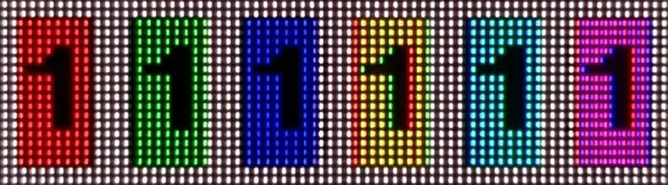

The photograph below uses all the primary colors (red, green, blue) and all the secondary colors (yellow, cyan, magenta). The primary colors don't need any blending but they exhibit black vertical lines due to uneven gaps between pixels:
The red box has a 4-subpixel gap on the right (R____W__).
The green box has a 5-subpixel gap on the left (_W_____G).
The blue box has a 4-subpixel gap on the left (_W____B_).
The secondary colors blend differently depending on the proximity of the required subpixels:
Yellow blends the worst because the subpixels are very far apart (R__G).
Cyan blends the best because the subpixels are right next to each other (__BG).
Magenta has moderate blending (R_B_).

Your post is very correct.
I knew about all this already too; It is correct R and G is spatially far apart in RWBG, unlike for RGB and BGR.
Conversely in fair defense of LG -- this line of thinking allows you to easily explain why Samsung QD-OLED has the green/magenta fringing behavior. See this image from RTINGS is very easily explained in the very exact same way:
(individual subpixel shapes can vary, the Alienware OLED is slightly different but still triangular)
The green subpixels at top of a "pixel", the red/blue subpixels at bottom of a "pixel" creates the green/magenta fringing. White objects with sharp edges (computer graphics) on black screens. You have a green fringe at top edges of white objects on black backgrounds. And purple fringe at bottom edges of white objects on black. Because those are the last subpixels illuminated against a totally black background.
Regardless of LG or Samsung, the choice of pixel structure can create side effects. Even plain LCD RGB can have color fringing, just less visible. Like the red left edge / blue right edge white boxes on black backgrounds LCDs. So even RGB and BGR is not immune. But much less so than more unconventional pixel structures that increase relative spatial distance between bright subpixels (bright color primaries).
At higher pixel densities and further view distances, this all can become a nonissue, but low pixel densities at close viewing distances, this can be annoying to some, without mitigations/tweaks.

You can almost do this in software as I have demonstrated below. The right image looks better when rendered on my Asus OLED panel. The only problem is a missing column of yellow pixels on the right side. I can't coax my monitor to display them because that would require lighting red subpixels next to white subpixels. The monitor firmware could presumably improve on what I have done.

Keep the photographs coming from everybody. They're useful. More the merrier.

Here is what ClearType looks like on my Asus PG42UQ. RGB mode (on the left side) has annoying artifacts. Notice the R+W+G shadow to the left of vertical edges. This artifact is visible at normal viewing distances and it is present regardless of font size. BGR mode (on the right side) is a total mess.
Everyone else too. Everyone who has OLEDs, please join in with your close-up macro photos.

The Better Cleartype Tuner link doesnt give me a way to download anything.
Its text only referring to newer versions, nothing more.
I'm confused.
I'm confused.
Pendragon beat it to me, you have to go that screen and download 1.4.0.2 from there.
