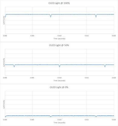

Which one did?
The oldest LG OLED television test from Rtings (september 10 2015) shows no PWM modulation.
https://www.rtings.com/tv/reviews/lg/ec9300-oled
In fact, as there is no backlight in any OLED display, there is no way or need to use PW modulated backlight.

Mobile OLED displays definitely do have PWM. My Samsung S8 flickers at 240Hz at anything below max brightness. I think it's due to power restraints making distortionless DC dimming like OLED TVs have impossible. Not sure, though.
I didn't dig deep into Rtings before, that's good to know. What I read saying TVs did have PWM must have been misinformed, which is believable.

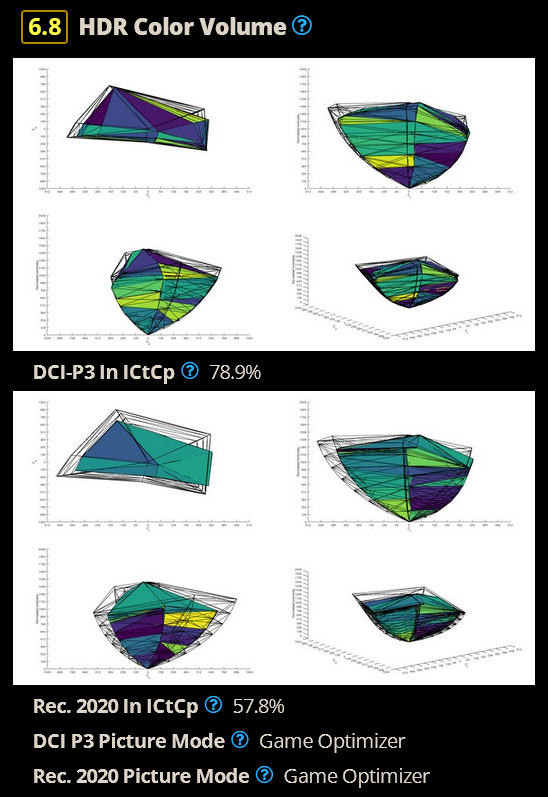

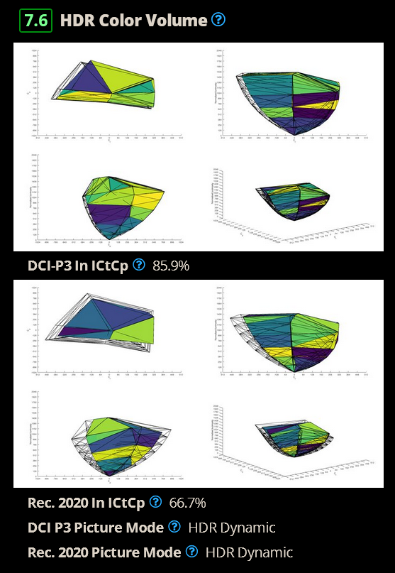

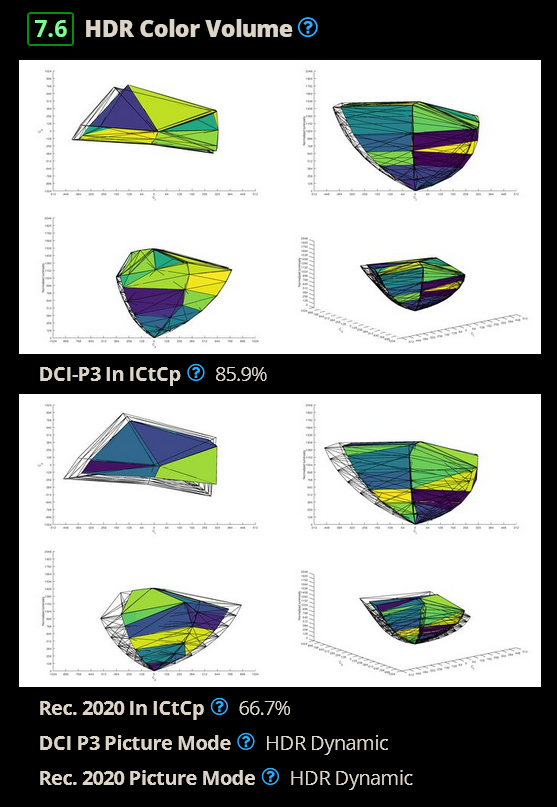

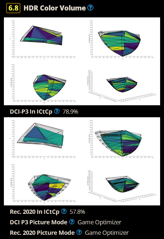

There is really no comparison in HDR when it comes to bright colors. OLED's are really muted compared to a PG32UQX. It's really one of the Asus' strongest characteristics because nothing outside of those $10000+ professional displays comes close to it's gamut coverage.
Here is the G9 Neo with it's really poor 89% DCI-P3 color gamut vs the C1 in terms of color volume:
G9:
C1:
G9:
C1:
In that case I agree. 7% and 9% difference in color gamut is noticeable indeed.
In sRGB space, though, I expect them to look identical.

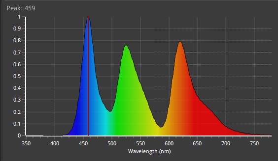

Yeah...
LG CX spectrum at 6500K
If I showed the "CX OLED" graph to random person and ask what produces this spectral distribution they would say it is typical W-LED backlight of the typical W-LED monitor and not "OLED"

In comparison actual OLED monitor (LG 32EP950) with true RGB OLEDs. Each pixel is its own type of organic filter. No blue OLED + yellow phosphor + color filters nonsense.
Light spectrum matters a lot for eye comfort. It might be even the single most important factor.
I have seen bad displays with light that causes my eyes to experience pain, especially at higher brightness levels and I have seen displays which can be watched very bright without any issues. People jumped to conclusion that PWM causes these issues but that does not explain why some PWM monitors are perfectly usable while some PWM-free monitors are terrible. In fact most early W-LED panels had terrible LEDs in them with high luminance blue light peaks. If on top of that they had flicker then it is easy explanation. Easier than "light spectrum" and some graphs... though from this graphs one can easily see there is something going on there ;)
In any way, LG OLED TV's are not really good representation for OLED when it comes to light spectrum.

Unfortunately all the OLED TVs based on LG panels flicker and in my case this also causes eyestrain and headache. Had to return an otherwise beautiful Panasonic OLED due to this.
The dips in the graph you can see in post #7 indicates drop in luminance. Seems to be the way these panels refresh so none of the TV's options affect the flicker.
It's pretty easy to capture the flicker using a camera and playing around with different shutter speeds. See attached gif
