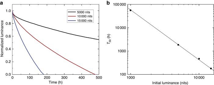

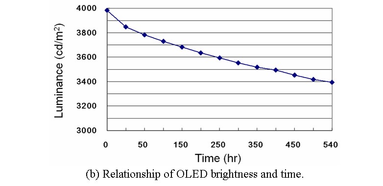

Here are a couple of graphs showing OLED degradation over time:
Sources: 1, 2
It's not completely linear, but the degradation certainly doesn't flatten out enough to suggest that intentional full-screen aging is a good idea. On top of that you have LG's built-in compensation algorithm, which attempts to mask burn-in by tracking use over time and gradually increasing the driving voltage on a per-subpixel basis. That's going to keep unburned parts of the screen at a more or less constant brightness, at least until it runs out of headroom to use for compensation. Meanwhile, the already burned-in areas will continue to get visibly worse.
Sources: 1, 2
I don't know what OLED technology graphs those are, but in RTINGS burn in tests the brightness has actually gotten even a little better over time.
Why do you think that is? Everything we know about OLEDs says they only get dimmer over time, that in order for them to get brighter they'd need to be effectively aging in reverse - an impossibility for the technology.
The most likely explanation for Rtings' results is that those sets are still within the overhead the compensation algorithm is given to work with. This would explain why they appear to have gotten slightly brighter: the algorithm is slightly overestimating the rate of degradation, and overcompensating as a result - the same effect as the burned-in areas have exhibited.
