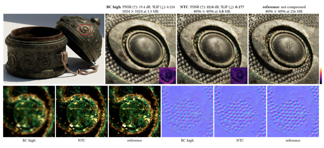

It's lossy compression, which means you lose some of original image quality. According to this article "Researchers observed mild blurring, the removal of fine details, color banding, color shifts, and features leaking between texture channels". Furthermore, game artists won't be able to optimize textures in all the same ways they do today, for instance, by lowering the resolution of certain texture maps for less important objects or NPCs. Nvidia says all maps need to be the same size before compression, which is bound to complicate workflows. This sounds even worse when you consider that the benefits of NTC don't apply at larger camera distances. It's basically like DLSS which will cause texture filtering. The image you're looking at is showing you a worst case scenario, vs NTC. The best case scenario is that you have more VRAM and actually load a higher quality texture with BC7. Also 1ms to decompress a 4k texture is very bad and 2 - 4x slower than the highest quality traditional compression method while using RTX 4090. Another thing to keep in mind is that Nvidia's tensor cores have gotten much faster each generation, meaning that this is much worse for those on the RTX 20 and 30 series.
Here's the picture you really need to see, where it shows you how the texture looks before NTC then after. BC7 will use more data, but again we just need more VRAM and not some special compression that is absolutely going to be Nvidia exclusive and will likely reduce performance due to the latency.
They took 256Mb and compressed it to 3.8Mb. Of course there's going to be loss. You are missing the point.
It looks pretty damn good, and looks better than any other compression while being smaller. That's a win.
That image is showing you Nvidia's interpretation of BC7 compression. You can use more data for BC7 and still retain more of original texture. In other words, you need more VRAM.

Lot of useful posts, it'll be interesting to see how easily they make it available for game dev. I'm personally all for better compression it's been needed for a long, long time now. It sounds like with tensors it'll reduce build time as well which is another huge benefit.
Also, you don't need a supercomputer farm to make these textures. It's just math for Gaben sake. Also this is BC1 vs uncompressed when you use a bit more data. Doesn't look so bad, now does it? Sure you need to use more data, but it doesn't look noticeably worse.
Not about making texture ? This is a compression-baking algorithm. We are talking at fitting them on cheap hardware for real time rendering.
Most consoles run AMD hardware, and I doubt they need NTC anyway.
It is not about NTC, they need heavy compression of asset, the question which one has the best compromise on size, quality and performance, this as not much if anything to do with nvidia or amd hardware that I know of, could you explain ?
The idea is that you don't need tensor cores over specialized hardware. You wouldn't use the CPU to do this, that would be silly. Nvidia is using tensor cores because they are doing nothing else otherwise.
Tensor is for fast baking, not used for the real time rendering according to the paper, shaders matrix operation
It could and would make sense, but I feel Nvidia's NTC is just a tech demo meant to make Nvidia 8GB card owners less angry that the RTX 4060 and 4050 will also come with 8GB of VRAM, or even less.
By the time this would end up on actual PC game (think time between Unreal 5 demo and actual game, direct storage demo and actual game), not sure how relevant those cards would be. This seem to be quite the conspiracy mind, how long do you think those research have been going on ?
Hard to say, this is not about looking at picture of the diffuse map, this is compressing all the element of modern texture (diffuse, normal, displacement, etc...) in one go, would need to see in actual 3d rendered action. you could show me a picture of a lossless jpeg that look the same as the original once read... and ? It is all about the size and performance, outside that context what the point at look at it ?

Ok but at what point does this matter for games? A quick Google doesn't show me any benchmarks for this, nor any games that make relevant use of it. From what I'm reading it's barely a bit slower, but again no benchmarks.

From what I've read NTC uses tensor cores and AMD hardware doesn't have tensor cores.
