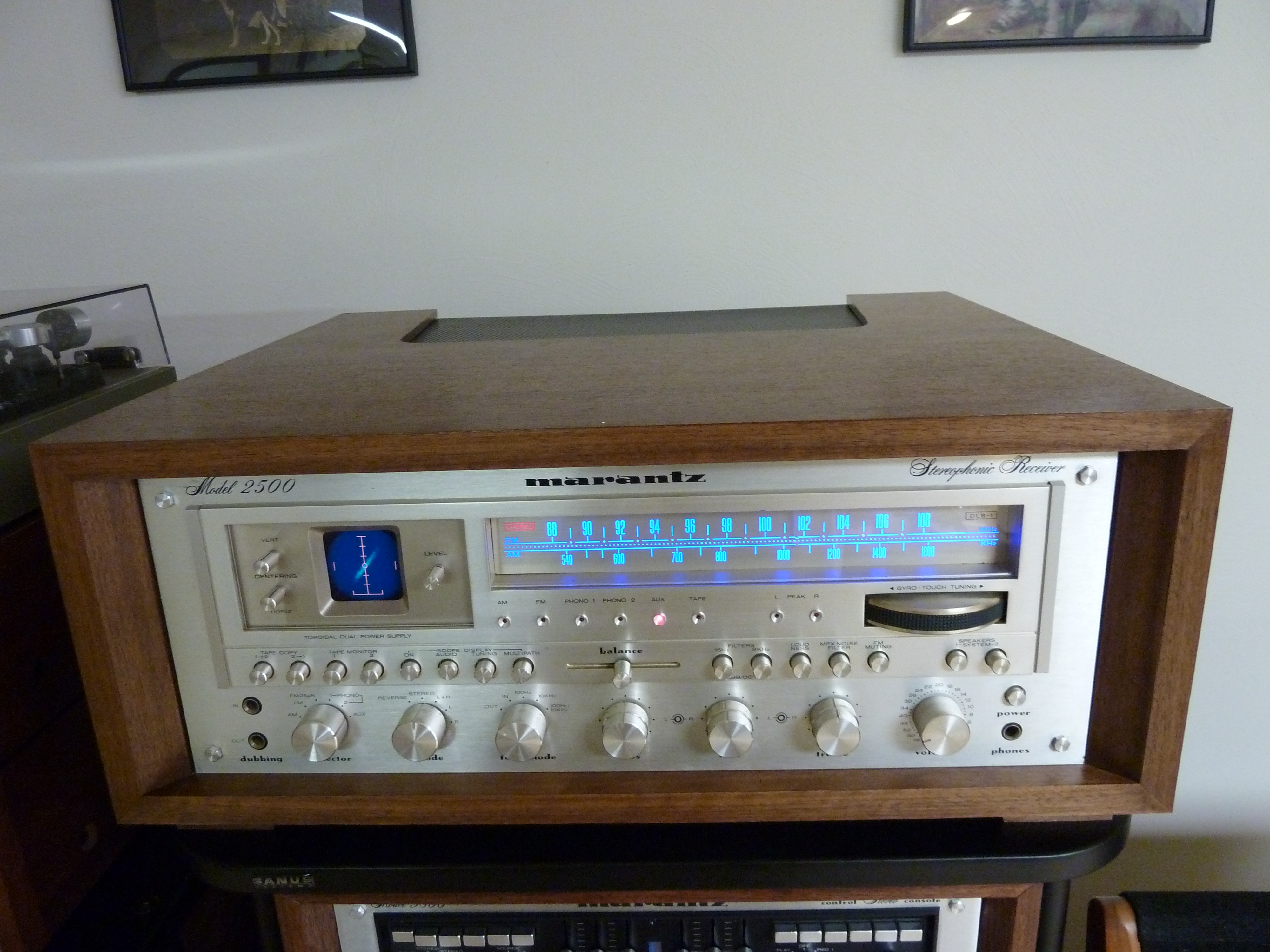

The visual design is very heavily inspired by vintage HiFi equipment. Its housed in a wooden case, and has a brushed aluminum faceplate with heavy-duty switches and knobs.
