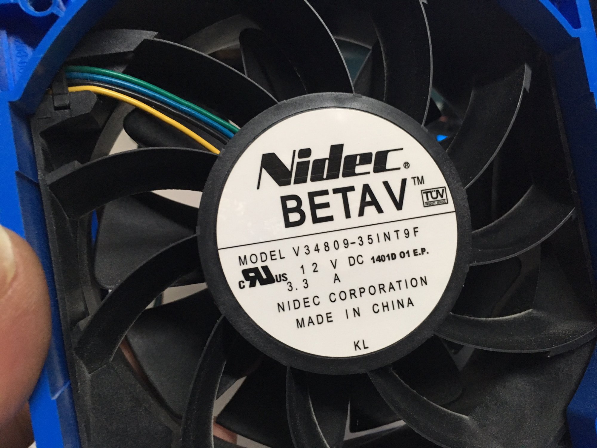

Are you saying that this fan can pull up to 15Amps from my fan header on startup?
What pendragon1 said.
Fans with 3.3a rating are not designed for our computers and that's what we talk about here.
But it came out of my computer. It's the rear chassis fan,
A personal compiter with a 3300rpm fan rated at 65dB is definitly not normal. That's as loud as a lawn mower! Could you please give us the make, model, year and detailed list of components in your computer?
looks like a dell or hp work station system. ive seem abnormally high amped fans in dells lots of times but they have special headers and never run full speed.
Zepher , I appologize for not believing you. That is way more powerful fan than normally seen in our computers.
Maybe Nidec gave them a very good deal on the fans so Dell made system that can handle them. That said, I see no logical reason for any personal computer to have these fans. Even fans half as powerful can product penty of airflow .. and at much lower noise levels as well.

It's an Intel SC5650 chassis with my Intel S2600COE motherboard and Dual Xeon E5-2670's and 128GB Ram.
the front fan is also a Nidec and is 2.x Amp, during post when the system ramps the fans to 100% it sounds like a leaf blower.
