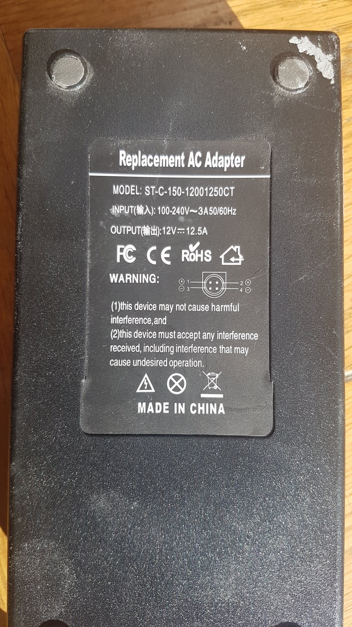

Hello all

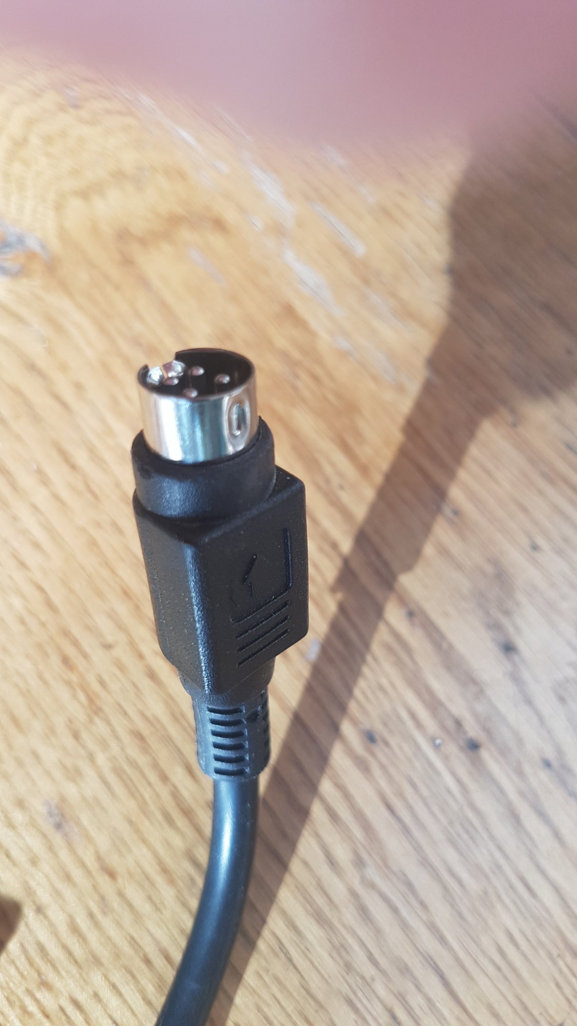

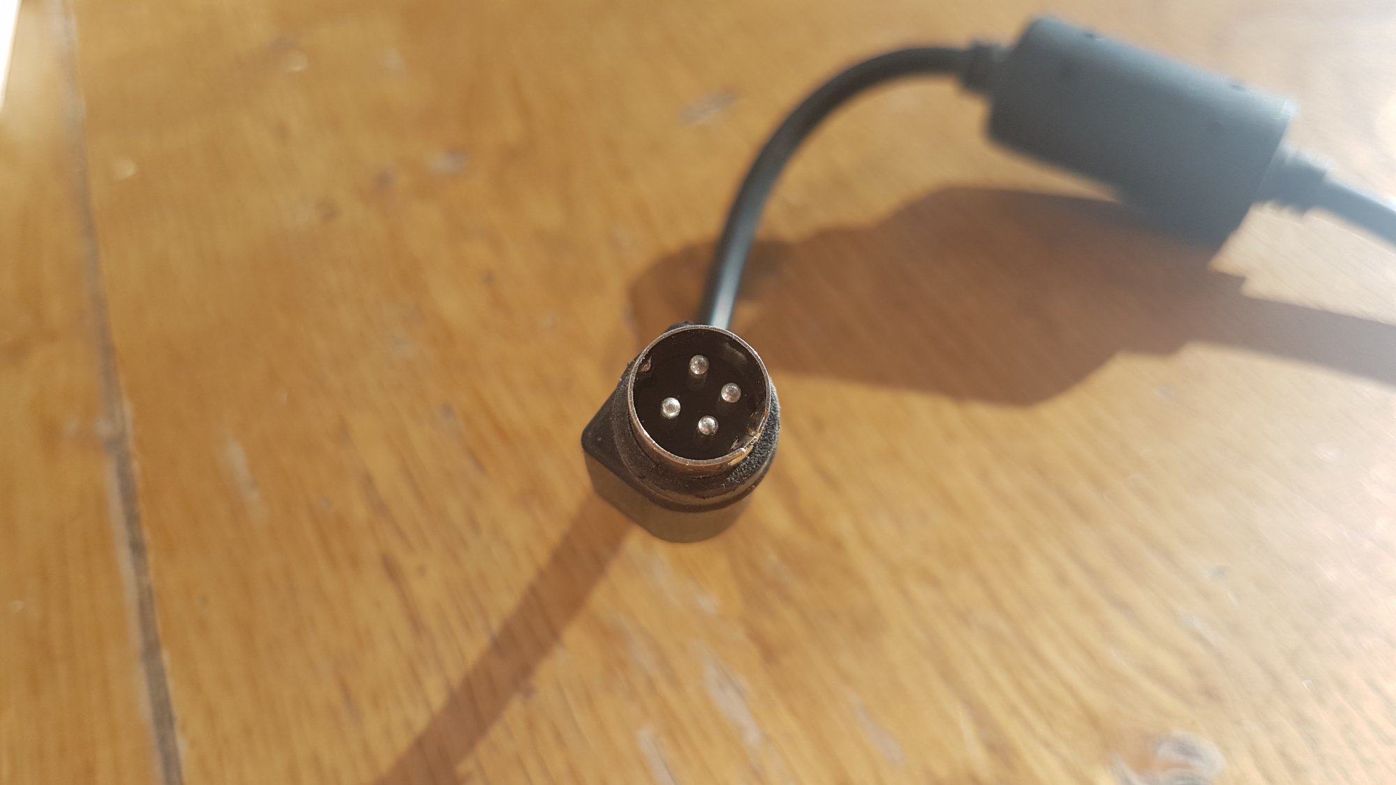

The plug on the end of this power supply is broken, in that the pin section on the end comes away from the body of the plug. Does anyone have any idea what this kind of 4-pin power supply plug is called, and where I might find a replacement for it?
Thanks!
Andy
It'd be really helpful to know what it powers. Generic IED Chinese PSUs don't often cross reference to anything.
Sorry I may not be able to be of much help as It powers a mini-PC custom built by the guy I bought it from. It's used as a media center, couple of SSD's.
I have that connector on numerous external hard drive enclosures.
Yes I bought an external CD-RW drive for the internal drive itself as the power supply was no where to be found in that store they probably never even got it with the drive
Anyway it was 12/5VDC as most of the uses for this plug are.
The connector is available if you want to chop the end and re-terminate the end.
https://vetco.net/products/4-pin-mini-din-kycon-snap-and-lock-dc-power-connector
Neat but when I hear "Mini Din" I think of the S-Video or PS/2 style thin pins not the bigger gauge pins like these use.
