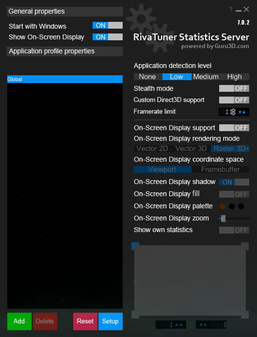

Take a look at the above link. Riva tuner creates less frame delay. Might want to give it a shot.
+1 for RTSS (Rivatuner). I've been limiting to under refresh rate like previously mentioned since back when severe coil whine was a problem for power-hungry cards.

It doesn't work --- what am I doing wrong? I tried to limit it to 118FPS and it's just behaving like it did before I installed RivaTuner. This attempt with Star Wars Battlefront 2.

Guess it's back to making Rivatuner work (or using nvinspector which gives about 2 frames of lag, not really perceptible at 100+ hz but still technically a bit worse).

I've also found that frame limiters on my system only work in +/- 5 increments, so try setting it to 115.
