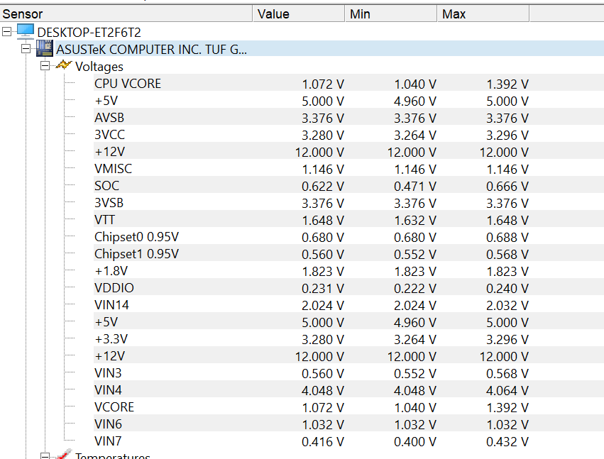

I'm curious what your SOC voltage was. It might not matter, but I have read some comments in other places about it. I put mine to 1.1 it was 1.3 out of the box.

i am curious too
wondering if my motherboard slowly killed the 9800X3D, but i had no symptoms, crashes or anything

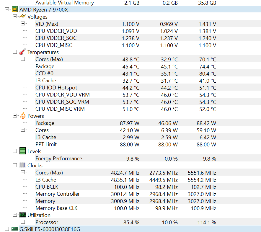

with the 9700X so far:
This is what I was referring to, see that vcore and vid max all the way up to 1.43 volts? To meet that is crazy high. I would keep it below 1.25v to be safe or 1.3v max. Some are totally ok pushing spikes beyond 1.4v but I'd rather play it safe and stay below 1.3 in the 1.275 max area personally.
Idle vcore is right at 1.4V for AMD CPUs since AM4 when I started using them, and that continues with AM5 across many CPUs (7800X3D, 9800X3D, 9950X3D). It's just what they're run at (mine and friends'), and under load it drops down. Though full disclosure, I do run my 9800X3D at a fixed voltage of 1.23V and 5425MHz.

As for OP, it could have been SOC voltage that killed your 9800X3D. Are you on the latest BIOS for your ASUS X670E? I'm on the same board and CPU as you and I recall them issuing BIOS updates that lowered SOC voltage to stay under 1.275v
