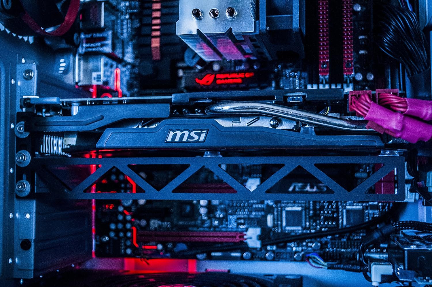

I know this is an ancient thread, but I came across something today that I think is relevant (maybe they didn't exist when this thread was started).
Search for "gpu support bracket" on Amazon. There are a bunch of options for adding support for a GPU. Like this:
Looks like a rip of MNPCTech's beautiful brackets. It definitely didn't exist when I made mine.
