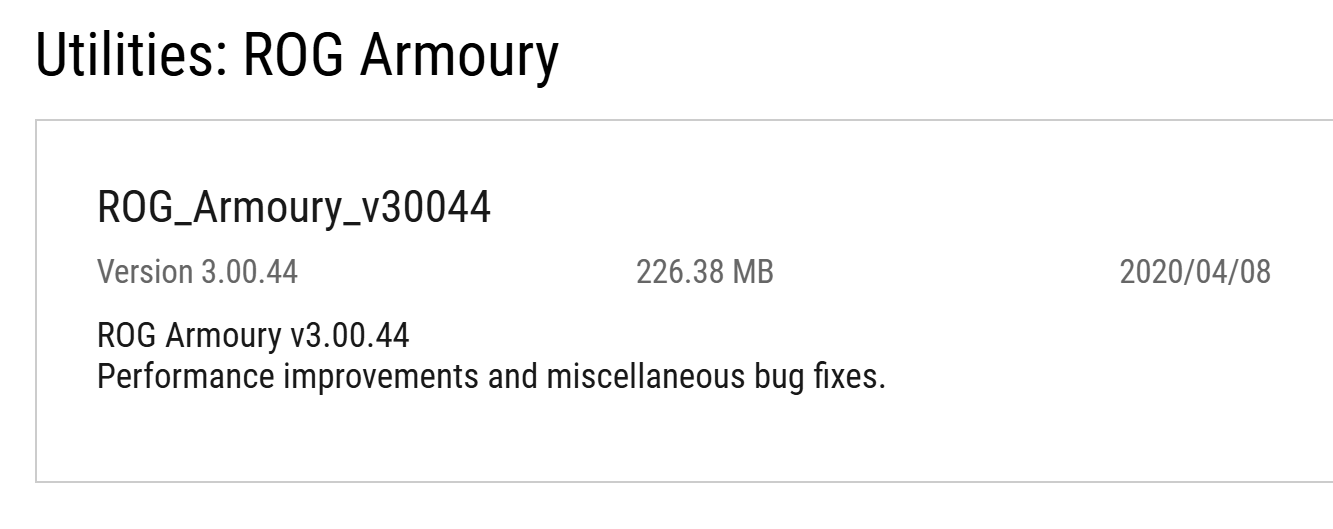

Try deleting the Asus software, without it and with it. Try deleting and reinstalling the drivers. Try the USB 3 connectors.
tried this thing?
