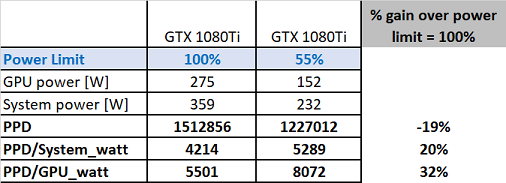

Feedback on my experience on a TR/1080Ti Linux box using the same parameters you used (eg no cpu project running):
At 100% power
At 55% power
Summary
The ppd was estimated by taking the last 20 tasks completed from each respective power level.
I have a suspicion that, with high end gpus, the opencl app can be bottlenecked by the cpu. Regardless of gpu power settings the tasks seem to take up an entire cpu thread whereas the Linux cuda app used to only use about 25% of a thread.
Thanks to you and Gilthanis for the all the opencl and power optimisation pointers.
Thanks for sharing your finding. If you run two 1080Ti in a single rig, the system efficiency will increase more than 20%. Those 1080Ti are super-efficient, alas don't have the fund to get one yet....
