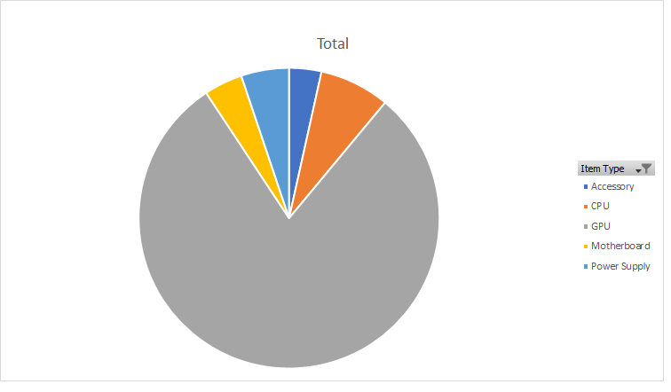

1.) Distribution of Costs by equipment type (see graph)
What I've found is that, unsurprisingly, GPUs are the largest expense. This is followed by CPUs, Motherboards, and then Accessories. From my experience Accessories should probably be a little higher depending on how you set things up. If you buy expensive $150 mining rig setups and spend awhile finding the right fans, cables, etc., I would say Accessories would be the #2 expense at around $2k or around 10% of your total expenses. This is avoidable, but it's something you need to watch out for so you don't waste money on items not earning you any direct profit.
Power supplies are consumer level power supplies. The positive to this is that you can run these in your home without going deaf and keep things relatively normal, the negative is increased power costs and increased equipment costs. Using server power supplies would decrease your upfront expenses by about 50% or more but might not be a good fit for everyone.
Rough Cost Breakdown (On a $22-25k budget)
Accessory $795 3.47%
CPU $1730 7.56%
GPU $18242.85 79.67%
Motherboard $950 4.15%
Power Supply $1180 5.15%
(I left out RAM, and probably didn't account for all the misc. costs so I would increase the Accessory amount to roughly $1500 or so).

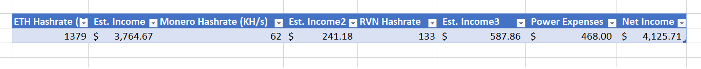

2.) Income
So you've spent $25k in mining hardware at peak levels, so what does that get you? Well, at a hashrate of about 1,379 MH/s (ETH), 133 MH/s (RVN), and 62 KH/s (XMR), that gets you a net income of about $4,125 per month after subtracting $468 or so in power @ $0.10 / kWh. Your ROI is now approximately 6 months.

Should mining difficulty increases also be taken into consideration? Or is the assumption that if difficulty has increased so has the value?
Yeah, that's something I'd like to get into next. Based on past cycles, what would be a conservative estimate on profit? It's pretty much guesswork though. For example, ETH profits had dropped by about 50% the other week due to a combination of difficulty increases + the Berlin update. But it seems like increased use and increased price have now offset that.
