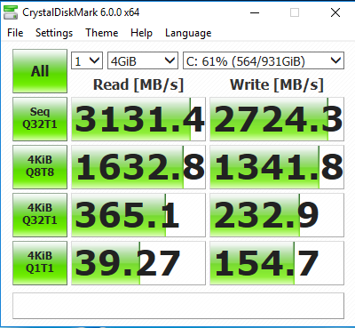

I changed my Bios to GEN3 for the PCIe speed however I also re-benched with Crystal Disk and got the following.
Would you say this is performing as intended for my 1TB WD Black M.2 NVMe drive?
