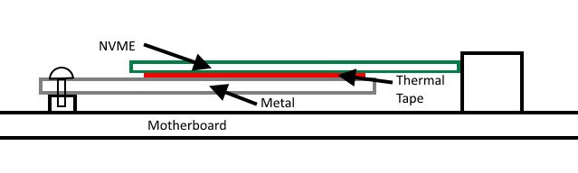

  7. westrock2000
    westrock2000 [H]ardForum Junkie
    Messages:
    8,936
    Joined:
    Jun 3, 2005
    Thin sheet of aluminum or steel.
    Some thermal tape.
    Cut the metal to be long enough to cover most of the bottom of the NVME and also extend to the desired stud.
    Drill a hole in one end of the metal plate so that a screw can go through it and into the stud.
    Paint the metal black or something if you want.
    With the NVME drive not seated, install the metal plate where it should be. It should be only connected to the stud and just floating.
    Put the thermal tape on the bottom of the NVME.
    Seat the NVME and push it down until it contacts the metal plate.
    You might be able to stick something skinny under the metal plate to sandwhich it against the NVME to make sure the thermal tape sticks.
    The NVME drive and the metal plate should now be as one solid unit. And should not move around or wiggle.
    The metal will help disappate heat and the thermal tape should last long time.

  9. mwroobel
    mwroobel [H]ardness Supreme
    Messages:
    4,895
    Joined:
    Jul 24, 2008
    Metal shim to m.2 drive.... Me Hold You Long Time!
